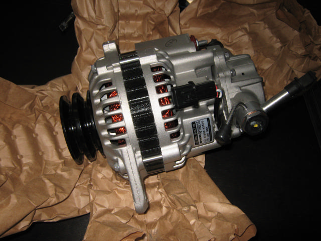

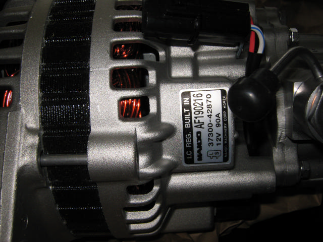

Wildtrak wrote:Hi!
If you find difficulties in your search for a 90Amp alternator for your L300, you may find the 110 Amp alternator for Hyudai Starex a good alternative. Fits perfectly to a L-300 4D56T engine, no bracket to alter, just align and tighten. Produces a good supply of electricity too. You won't go wrong.
There are good quality alternator with 110amp, 90amp, 75amp, 65amp from Hyundai.
For sure to get them.
But quite pricey for the Hyundai OEM.
Steven
