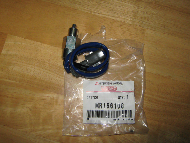

If you can't get out from 4WD for a while, change 4wd front axle sensor .
This is the only solution for that problem.
If you are aware of flashing light or feel uncomfortable/annoying at flashing light, replace 4WD vacuum solenoid.
Or you don't need to replace this if you don't mind.
Those are common for incoming delica L400, but we fix them all the time through replacing parts.
Simple is that.

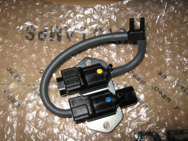

As mentioned before , the solenoids operate the engagement/disengagement of the front axle in relation to the front driveshatft - transfer case.

If that does not work, one of three things are possible (like Assiniboine said)
1. The control solenoid(one or both) is broken and needs to be replaced
2. The vacuum switch on the front axle is broken and needs to be replaced
2. The connection in the back of the instrument cluster is loose and needs to be either cleaned or replaced

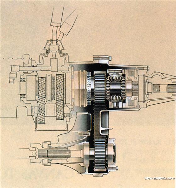

From this site: http://www.awdwiki.com/en/super+select/
Kinda looks like a center diff in the transfer case to me...
All I'm saying is that perhaps the second "CDiffLock" sensor (the one on the Xfer case, not the one on the selector lever) is there to inform you if something inside the Transfer Case is binding/hung up despite the selector lever getting moved. That's all. If not, I still don't see the point of having it there. (there appear to be 5 sensors in total for reading the various states of the Xfer case).
But as I said, I've never had one apart, so I can't picture what this sensor inside the Xfer case is actually looking for...

Same for me in 2H/4H. That's why I'm trying to uinderstand how the VC/Centre Diff mechanism actually locks and unlocks; I get the same behaviour from 4H to 4HLc.
If I just move the floor lever into 4HLc, the orange light starts flashing, but I often have to on/off the gas or roll it forward/back for the light to go on solid. I have to believe that there is something else happening inside the transfer case.

psilosin = if your indicator still falsjing it need to replace just the vacuum sensor not a big problem.
it wont hurt or damge your tranmission:
