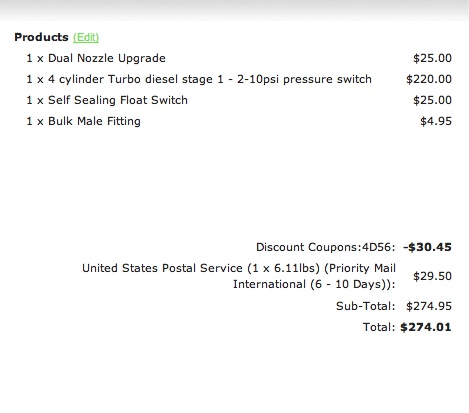

As it stands this is what the cost would be + or - a few options...
Picture 13.jpg (37.16 KiB) Viewed 5894 times
By ordering more than one kit the shipping cost would be cut by 1/2 for each of us (just about) and this shipping price is for here in BC, not to Blaine which would be around $11 for one kit.
No idea yet if it'd be worth to order the self sealing bulk head or the soft pipe adapter... I'm sure the kit can be installed without all those nice instant fitting pieces by using usual clamps but after installing a veggie kit on my bus and finding small leaks once in a while it might be nice to have something that works without headache.
Thanks for the update Guamdoc and additional discount.
