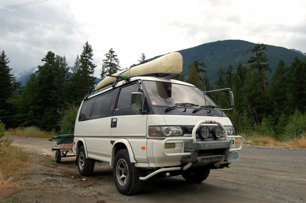

I have a high roof L300 and I have no problem lifting a canoe up onto my thule hightowers by myself - I'm 6'. As long as you take it easy and think about what your doing before you start, it should be manageable on any delica. And a canoe can be much less forgiving than a giant canvas bag if you make a mistake.
So buy whatever you like - I personally love my crystalite roof.
