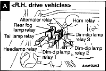

Anyone know where the headlight relay is located? I'm thinking that rather than wiring in a DTRL module it will be more elegant to just energize the stock low beam headlight relay directly. Only trouble is I'm not sure where it is.

Re: Headlight relay: where is it?
Post by chris »
headlamp relay.png (49.61 KiB) Viewed 6380 times
Post by jcolvin »
Thanks! Looking at the wiring diagram, ( http://www.delica.ca/manuals/L-400%20Ma ... dlamps.PDF) it looks like it should work, so long as I disconnect the headlight relay from the column switch. otherwise if i energize the headlight relay I'll also energive the column switch and probably turn on the rear lights.
Interestingly, the shop manual show a DTRL relay module that does not appear on our vehicles. The wiring diagram doesn't show it either.

hmmm , looking at the wiring diagram it looks like the lights are ground-switched. means it's more complicated to use the main headlights as DTRL, since a standard dtrl module won't work. in that case probably best to use the park lights. I'm surprised there seems to be nothing on this board about daytime running lights on the L400.

Christine, that picture is from the 95 L400 workshop manual - electrical wiring. I don't think it has been uploaded to this site yet. The file is PHWE9407_L400_95_electrical_wiring.pdf.
