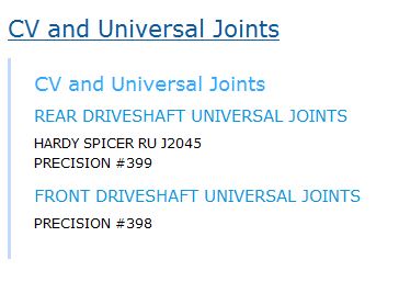

I'm in a bind, I need a rear ujoint part # for a 1990 five speed Delica, I've gone over the site but found only one and need to confirm, Hardy Spicer RU J2045,if this is a good match I'll drop it out now but ., if ther is another then please let me know I'm getting frustrated with parts dealers not knowing, I do nelive it's for a Montero.

rdub wrote:I'm in a bind, I need a rear ujoint part # for a 1990 five speed Delica, I've gone over the sight but found only one and need to confirm, Hardy Spicer RU J2045,if this is a good match I'll drop it out now but ., if ther is another then please let me know I'm getting frustrated with parts dealers not knowing, I do nelive it's for a Montero.

As posted on the wiki by CCautos

I can confirm the Precision 399 is the correct ujoint for the rear.

i just got one at napa and one at another dealer, different brands, both crossed the 399 to 1516. they fit in my 93 auto just fine
