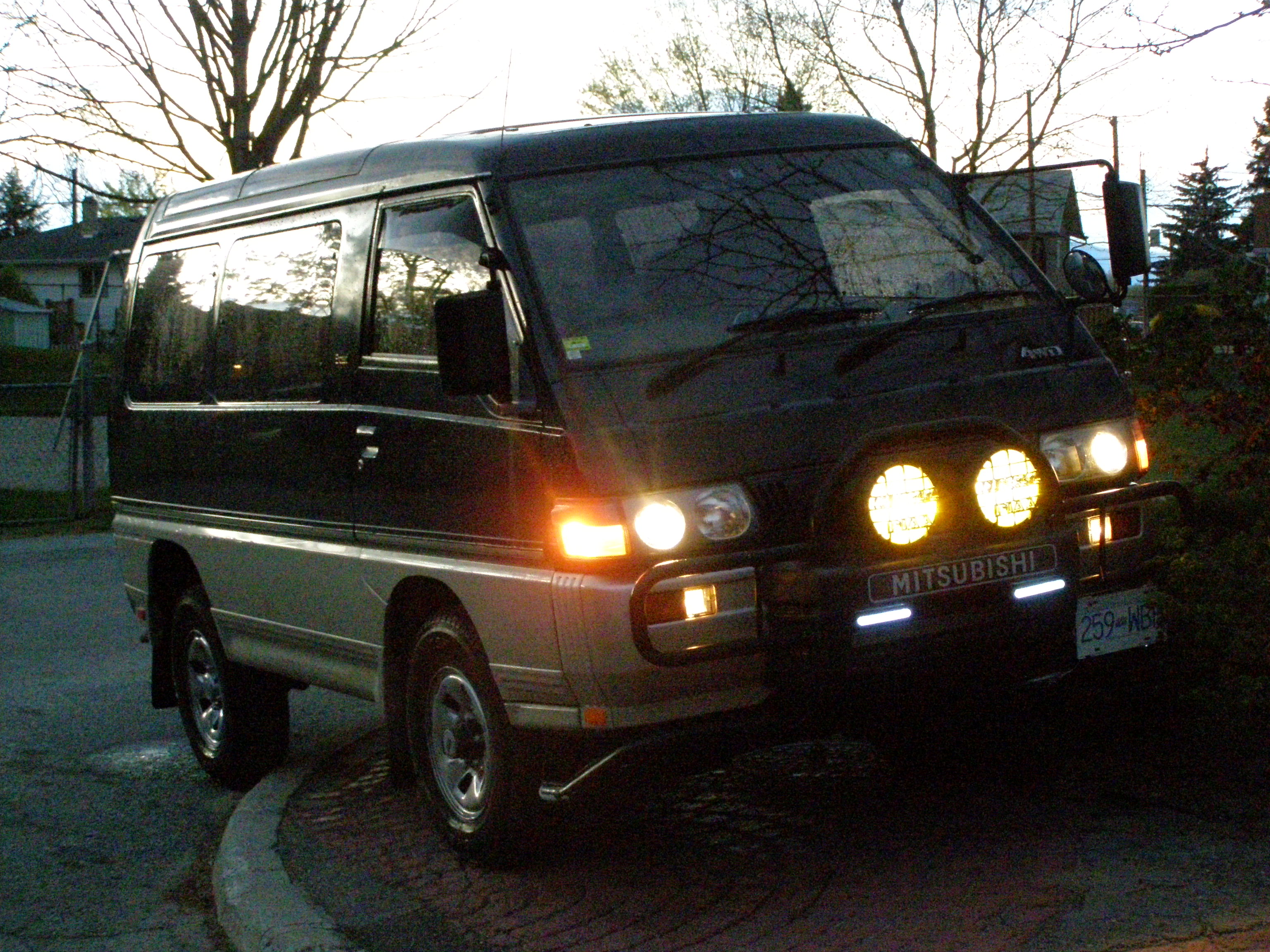

Mardy installed these on my ride about 5 months ago.I am totally happy with with them no problems at all.They look awsome at night.. 8-)

Awesome looking led's. They'll be my first choice if I can't put an LED or small halogen bulb inside the headlights. Price is good!
Wouldn't it be better to have the LED's (DRL's ) off when the headlights were on? or was the pic just for display?
Do you have a watt, lumen or candelas rating for that light?

Hi there,Thanks for the compliment.
The LED'S are on all the time.
Mardy Should be able to tell you what the Light output rating.
Cheers.
