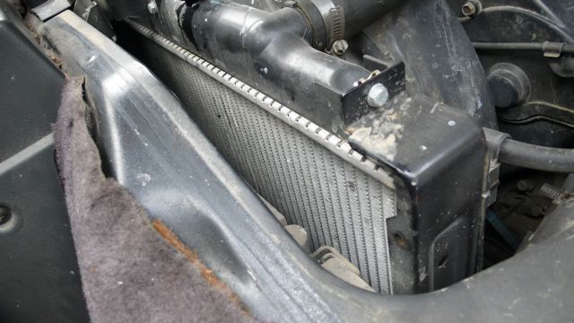

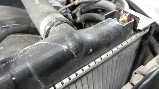

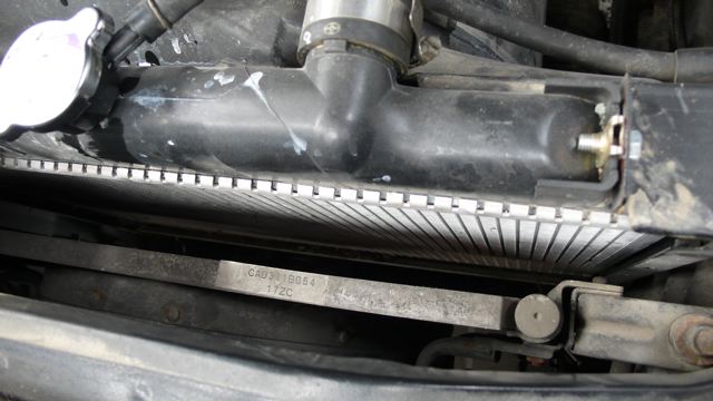

My core thickness is 1.5 inches with an outside bracket width of 2.25 inches; there is a half inch gap between the front of the rad and the bracket. Width is the same as yours. But top to bottom is about 18.5 inches.
Does your rad look anything like mine? In the photos you can see the gap between rad and bracket.

Re: Radiator thickness
Corax,
I have the same one. Thats a replacement. Its a tough as nails PVC type that should get you a good 5 + years out of it.
Yes it is a tad smaller than stock, but just as functional. Mardy from Amazing Auto sells that one. He sold me mine. I kept my stock rad in hopes of a recore before this new one is done.
Gregg
Edit - Corax, the second pic you took n now that I have my glasses on leads me to believe yours is metal. I would keep an eye on the temp gauge, but I dont see a really huge difference. It my be a different story in hot weather later in the year, but hell, run it as is for now and see what happens.
You have an aluminium radiator with plastic tanks, definitely not stock. I did a little on line research into the differences between the aluminium & the copper/brass rad cores and there are pros & cons. Apparently the copper/brass better transfers heat but doesn't hold up to pressure as well as aluminium. Aluminium weighs much less but has long term corrosion issues, especially with hard water. Ultimately aluminium is excellent for race cars that require a light weight, high pressure system that doesn't have to last for years, where copper/brass transfers heat more readily, lasts longer but doesn't take high pressure like aluminium and weighs more. Personally I prefer copper/brass over aluminium ~ but that's just me.
Google: "aluminium vs copper/brass radiators" and see what you find.
