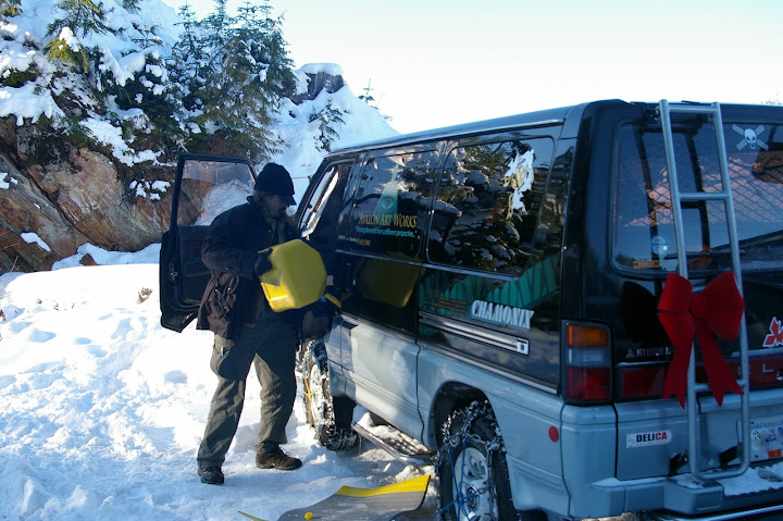

What can an L-300 do?
Here are some other links:
There's more if you look for it... smiles ~ knock yourself out.
- http://www.delica.ca/forum/another-story-3857.html
- http://www.youtube.com/watch?v=eprmfvQfEDs (From our Russian brothers, this one is impressive.)
- http://www.youtube.com/watch?v=-JtKUv65 ... re=related
- http://www.youtube.com/watch?v=W8NsNYIv ... xt_from=PL
- http://www.youtube.com/watch?v=HQBpyPMz ... re=related
