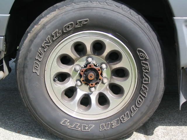

Compatible Vehicle bolt patterns?
Post by Delicaman »
Does anyone know if a Toyota 4runner or Nissan Pathfinder or Extera rim fit the Delica?
Mine didn't come with a spare at all!
I think the Mitsubishi front hubs are a little bigger that the 4Runner??!
I'm also missing a 4WD Hub cover. Can't do 4WD without it...
Anyone know?
Benn

Post by asorensen »
I am pretty sure that Toyota, nissan, and isuzu rims will fit the biggest issue will(may?) be the change in offset values.
I have replaced my factory hubs with manual locking hubs (the superwinch for the Montero) and I have kept my hubs for spares.
Chances are I won't ever need two of them so I could part with one of them. PM me if you are interested.
Andy

Yes, fellow delica owner they are all the same as toyota 4 runner, nissan fathfinder , Isuzu & other jap car with six holes on it. as long as its 15 inch wheels on it

bolt pattern is 6 on 5.5 6 bolts... i dont know what he 5.5 is but thats what to ask for. I know 4 runner rims fit, i believe all japanese import SUVs have this bolt pattern.

Did one of you offer me a set of Front Hub covers? I think the replacement will be a while from Japan.
[/img]
Benn

Hi, ben,you can get this front hub cover in US, its the same as 1988-1990 mitsubishi Montero 4x4, they got both same automatic hub, for sure you can get it.
