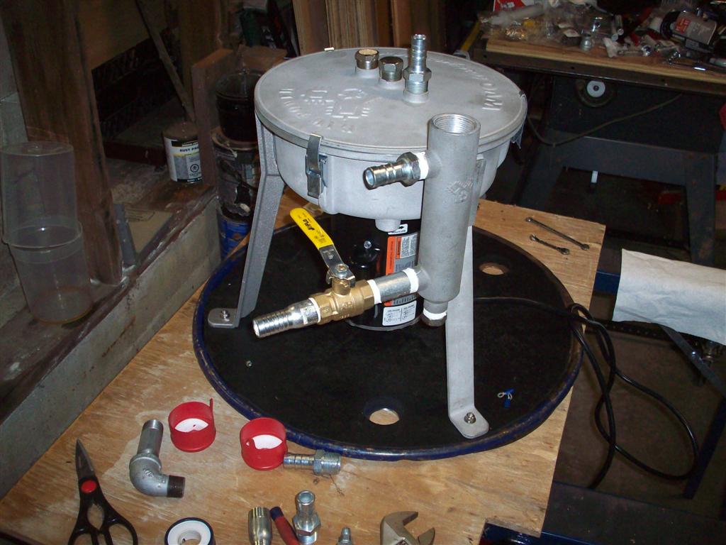

This is the unit in question. I actually had a lot more to do on it at this point (plumbing and heater) but the
bowl and motor were installed and I had been testing it.
I had wired up the motor and figured out the seals and whatnot,

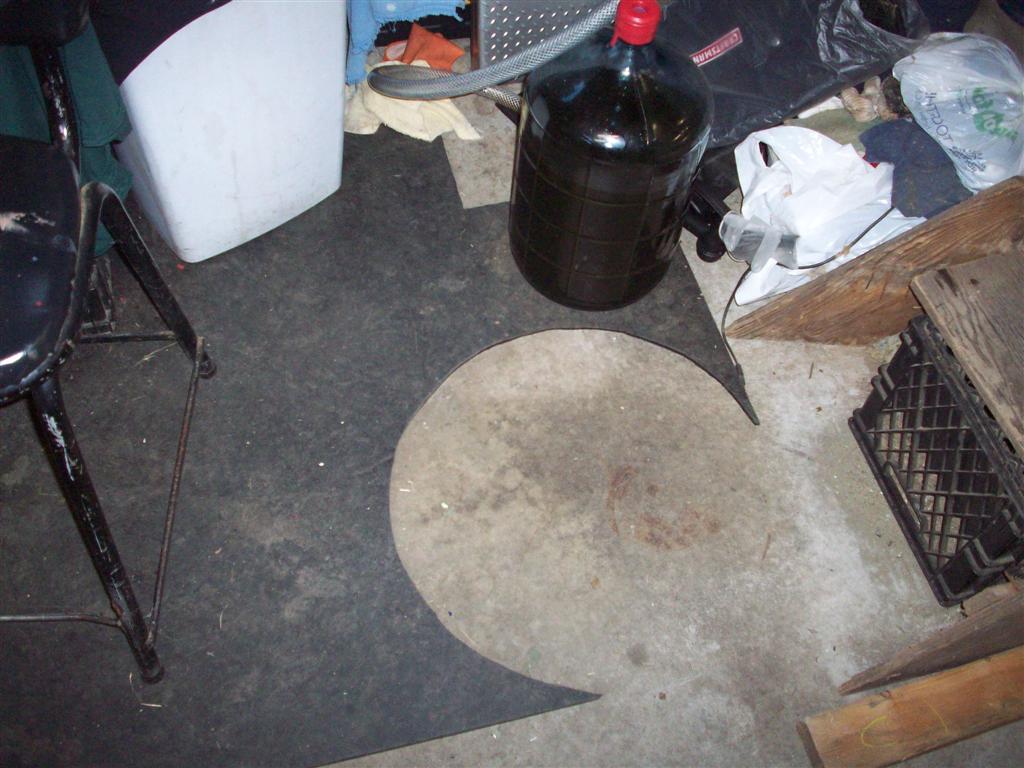

but had found it made horrible vibrations as it spun, so I made a mat out
of rubber (nice and thick) for it which took care of that almost completely.
I countersunk the mounting bolts with a spade bit and made some holes
where the spun oil will go into the barrel as well as a venting hole,they will get bungs welded to them
to accept 3/4 pipe.(that the barrel lid the mat is sitting in and the fuge on)
Cutting the mat sucked and took way to long with many opportunities to cut myself.
I cut it at a bit of an angle so it is a nice and forgiving fit.
Oh crap this isn't ready yet..

Where did I get the mat ,well....
it was cheap and available!
First Spin june 2009 002 (Large).jpg (110.07 KiB) Viewed 9228 times
Now I need another bench mat or maybe I will just shorten it...

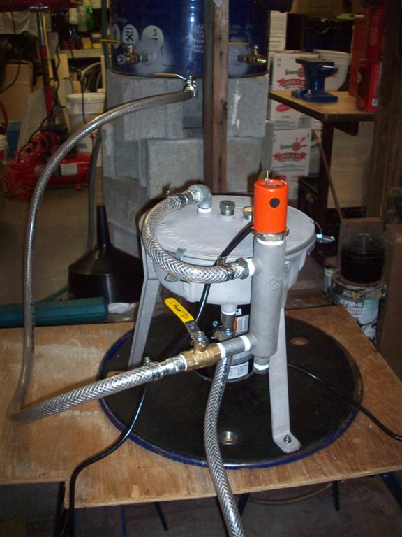

Its looking a bit more like it might actually do something,
the cylinder with the orange lid is the heater.(110v....for now)
NOTE: the hose coming of the heater particularly at the top
should be a more suitable heater hose,I just used it for testing and looky-lou
purposes,I actually melted the top one a bit doing this...hehehee

So let's get it on!
The Canola in question I am using here has been settled for quite a while and
decanted from a few different barrels. I did not heat my oil at any time during this settling
and I may actually do that to try and get rid of some of the suspended water that may or may not
(but probably is) in the WVO. The feed barrel to the fuge is elevated on cinderblocks ,
as well as being on a higher tier in my shop.(lucky me being on a hill)
So no pump for this part just gravity .
here we go..
here we go..
First Spin june 2009 005 (Large).jpg (62.26 KiB) Viewed 9223 times

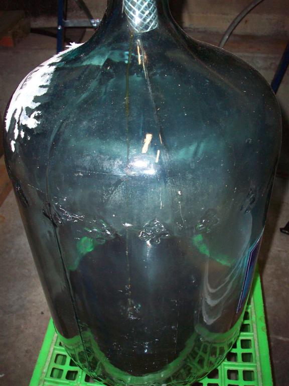

I used the glass carboys just for the test so I could check stuff out.
The pic shows the oil (heated and spun) starting to come down into the carboy.
On the bottom right you can see where I think was a bit of water (its a peanut colour)
in the bottom of my feed barrel I had a feed valve higher but I thought I was safe using the drain
valve because I had decanted a few times (if only I got air miles for being wrong).
Also worthy of note the oil had been filtered to 75 microns thus far,to 100
through stacked E-Z strainers then through the 75 aftter some settling and decanting.
(the 75micron was blocking up way to quick otherwise)

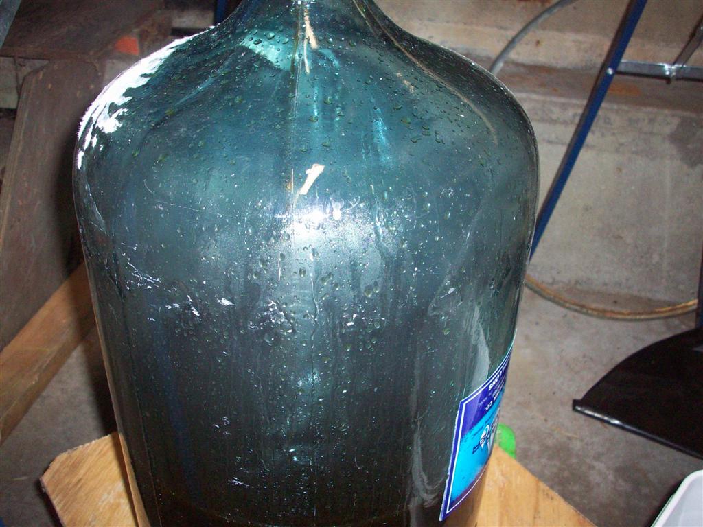

This next pic is interesting(though maybe only to the oil obsessed)
you can see condensation starting to form.
The carboy was sitting at about 80c and the top of the heater was 112c
so I am wondering if what we are seeing there is suspended water trying to evaporate away
or just bit water I sucked in at the start steaming off.

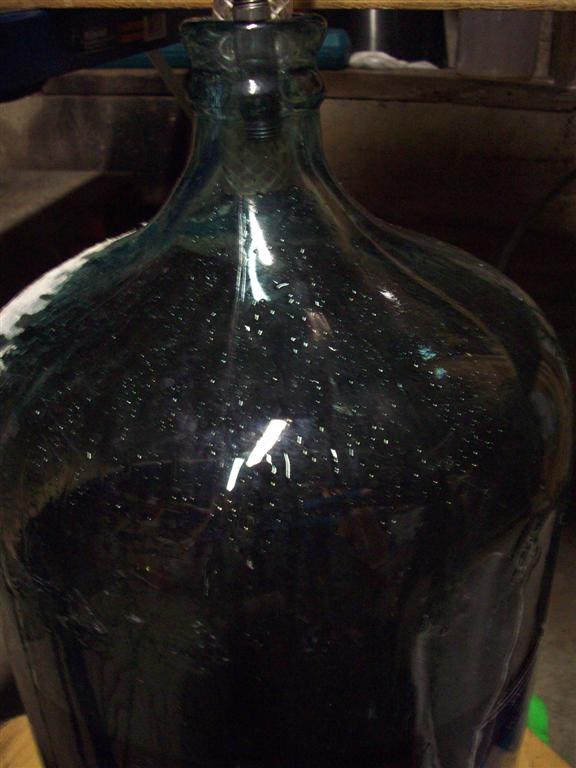

This next pic ( not the best pic) you can see the carboy is starting to get full,
took quite awhile.I barely cracked the valve I wanted the oil to spend
a good amount of time spinning.You can see at the bottle neck I stuck in a
little piece of pipe as a breather that actually seemed to work a little bit.
(will need a better vent solution though)
Slow and steamy

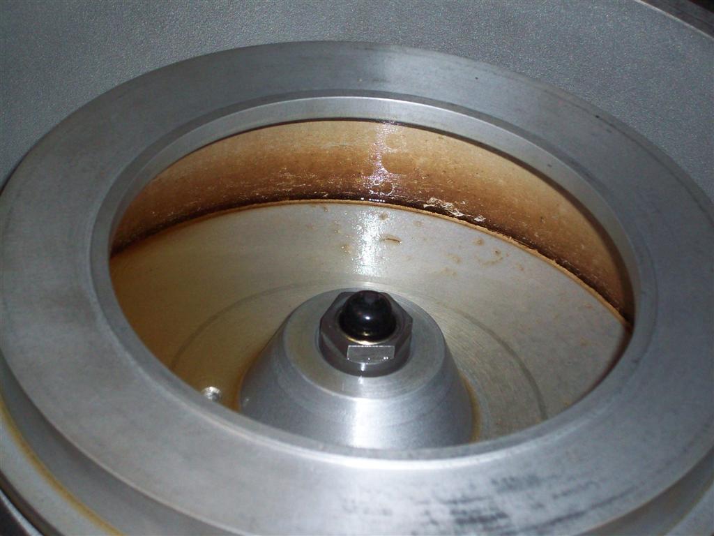

So here is the bowl after a carboy spin.
Took over and hour,not sure I will keep track on the next one,
but the slower the more time the fuge has to get medieval
on the gunkness.
Like the dark rings of uranus...
First Spin june 2009 010 (Large).jpg (82.6 KiB) Viewed 9215 times
I was happy to see the machine was working and doing something!
There are holes in the bottom of the bowl that when the unit is
at rest drains out any liquid(hopefully water)
leaving just the crud plastered to the walls of the bowl.

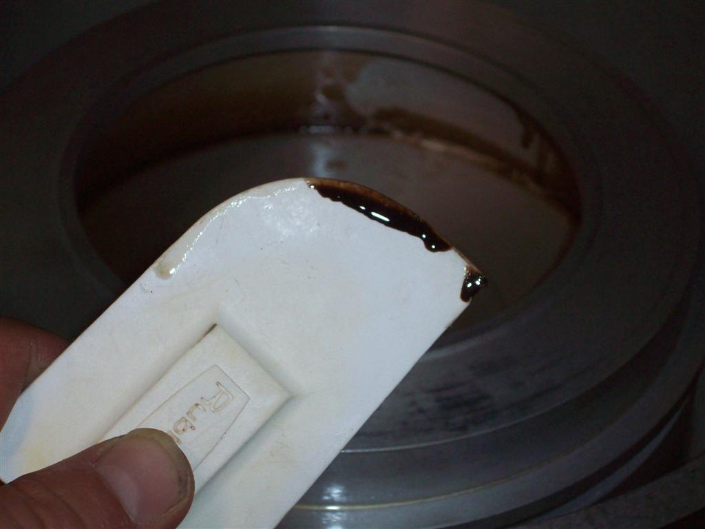

I grabbed a spatula and a box of crackers and
Mmmmmm Delicious!
Mmmmmm Delicious!
First Spin june 2009 014 (Large).jpg (50.91 KiB) Viewed 9202 times
checked out the crud. Ended up using a rag to wipe out the bowl
while it was still... HOT AS HELL.,OUCH ,gotta find those old welder mitts of mine
for this part. It kinda cool I did not injure myself until the very end,
I was pleased.....
The crud is a gritty and tar-like ,I have a feeling
if I had left it for the night it would have baked on.
Cleaned up quick and easy.

luna, the condensation thing is an issue. i can see vapor rising out of the clean barrel as the fuge drains into it.... there is discussion on the rpc forum but nothing conclusive.
i pan tested and got some minor crackling after passing through the centrifuge.

luna sea, did you ever come up with something to deal with the vapor? over on the RPC forum they seem to sort of pretend it aint an issue...

For now I have been heating the receptacle the oil goes into as well.
I have a bunch of tubing to do a coil condenser off the vent of the RPC,but have not done that yet.
The water that was condensed in
that (unheated)jug seems to have gone
to the bottom after it cooled.
I am making a few other changes and will post em soon(ish)
