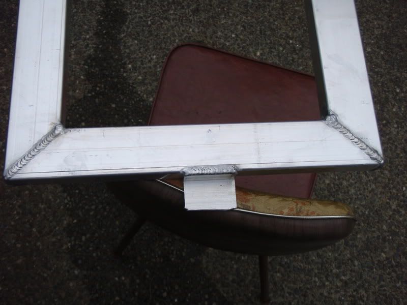

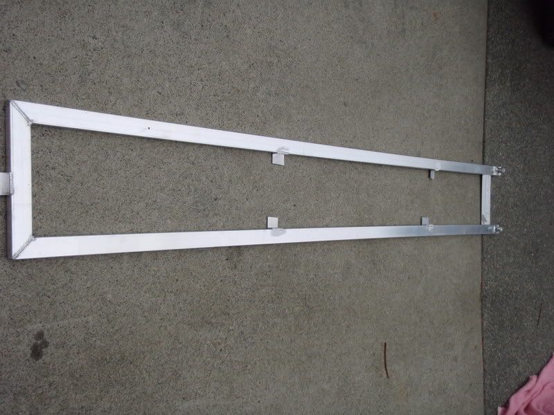

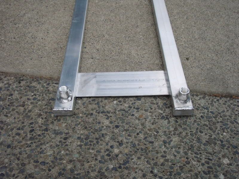

well maybe i should hold off on the milling machine then, Im allready swamped with welding work lol,
I made this today when I finished some other work, Its the first of my under floor heater segments, Its the 2x1 .090 Alum, I decided not to weld it to the flat bar, so i just welded tabs on so I could hold it up against the roof in the basement, Its 9Ft long, water will go in the one bung, go up the 9ft, over 270mill, will have ball valves on each end to fill with water and a bit of glycol in befor it gets mounted then the pump will be inline, circulating through the water heater and voalla, radiant heated floors, that will get later plumbed into a solar water heater on the roof. this one section will do my hall way, and was made to go between the joists... the aluminium will heat the floor and once a few more segments are done, my kitchen and living room will also be tied in....
what do you think?
Am I crazy, or just boored, either way, This will be the last year I EVER pay for any source of oil heat, Bio or cruid, my electricity will also be about 90% solar& wind by the end of the summer, so if Im not turning the hydro meter backwards, I will only be using a trace amount...

That, my friend, is awesome. On all fronts. Get a patent on that design! Where's your shop? It'd be nice to swing by sometime for a chat, if you have the time that is....

that's awesome I hope it works out as well or better than your planning. are you going to use anything to help create a thermal bond between the heater and the floor? air is really good at wasting heat the tries to travel thought it even for a tiny distance.

on the rails, there are tabs welded on, and ive beveled the edges of the material befor welding so a deep weld would hold and I could flapper wheel off the raised welds on the underside, so it will sit Flush against the floor boards that are under the hardwood, so since aluminium is always trying to get rid of hot or cold temp, it will be a great conductor, so the hallway will be very warm on the floor, so that will be my thermal bond, once i have the system up and running, maybe tonight if im back from the gym intime, so once its running and I know there are no leaks and i take a few picts of it, I will put expanding foam insulation all over the segment to further insulate it , leaving of course the ball valves and maybe the last few inches of it exposed for further access.

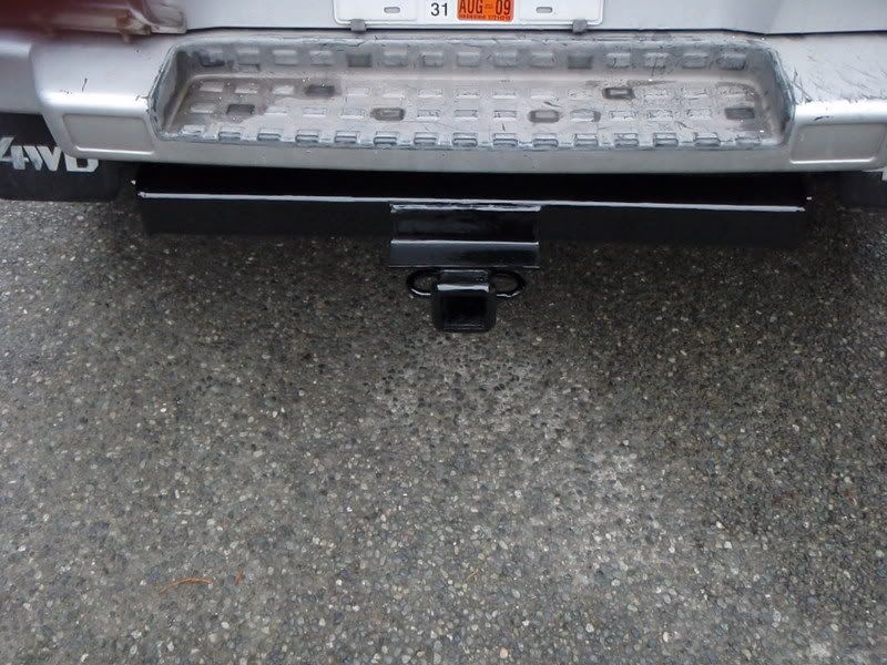

OH here, this is a pic of the hitch we made for Miles, Last weekend, Its Class 3, the spare tire stays where it is and is ideal for bike racks, and Small boats and such, the delica is just not strong enough for large & heavy trailers, so no hitch is ideal for those. but the Class 3 seems to be the best for options like racks, small boats, bike racks... stuff the delica is going to haul.
