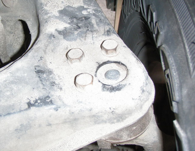

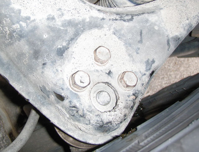

11 grease points? I doubt it, see below.
- P4260430_resize.JPG (92.39 KiB) Viewed 6491 times
- P4260429_resize.JPG (101.79 KiB) Viewed 6492 times

Sergiy, my guess is that you have seal ball joint( or it sure look like it), for my upper ball joint has a grease niple on it( instead of a shiny stailess cap like yours). my 2 cents!!

If CVI says there's 11...then 11 it is!
- Profister
- Posts: 963
Re: grease points on delica ????
No, no, no... Please remember that nobody is perfect. Pedro is absolutely right, I was just checking around...If CVI says there's 11...then 11 it is!
