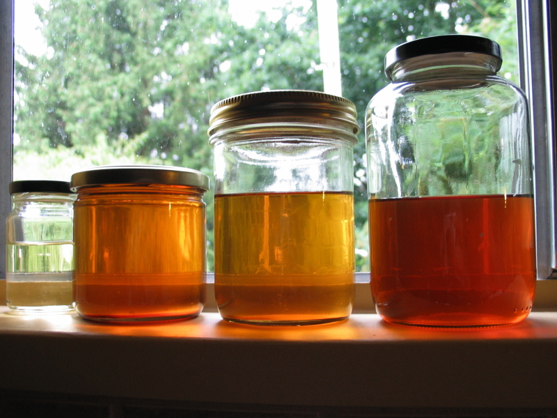

Here's a shot of oil that's been settling for almost 2 months on the left, 1 in the middle and the third has gone through the 30 and 10 micron stainless steel filter/pump setup.
The filtered oil looks completely clear until it's in the sun, but it reveals quite a high density of ultra-fine solids, so I think for the sake of engine longevity I will invest in a centrifuge for cleaning my oil eventually, but I'm not sure I really like the design of the Dieselcraft pump operated type, I'm looking at the http://www.simplecentrifuge.com variety instead. I just emailed the guys there and they say they have 20 completed units produced and they'll sell for $2200us + S/H once they put it on the website, so a bit bigger investment, but I think it allows for more control over the quality of the oil and should last longer before needing something fixed as well as being easier to clean...

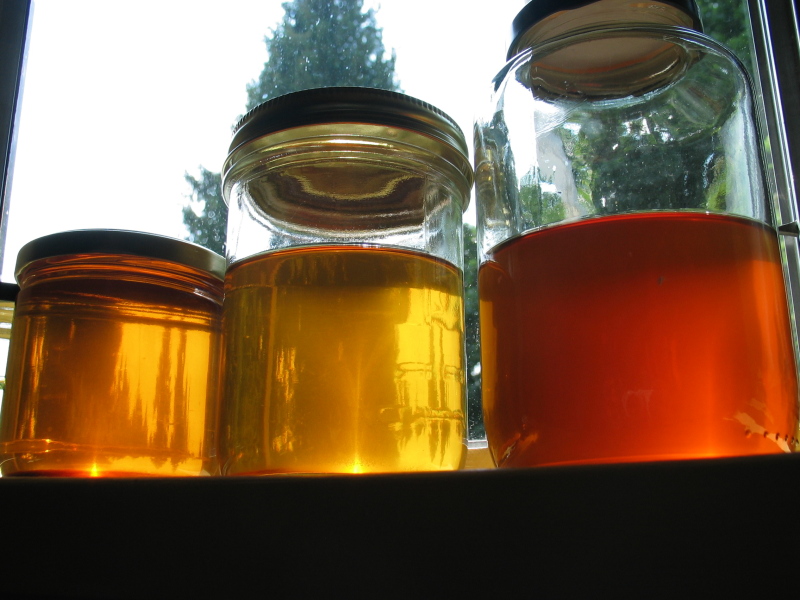

Here's what it looks like out of the sun: (jar on the far left is virgin Canola)
Although the filtered oil is darker, it looks very clear in this light.

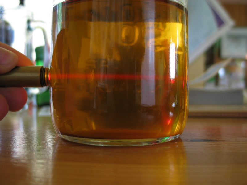

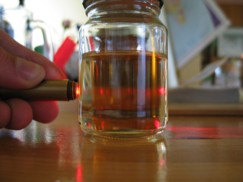

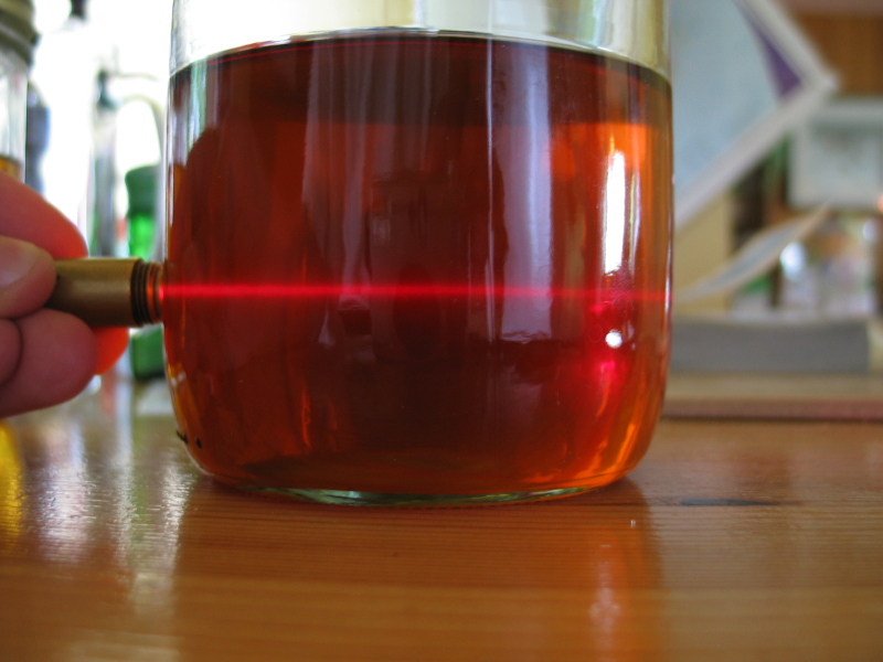

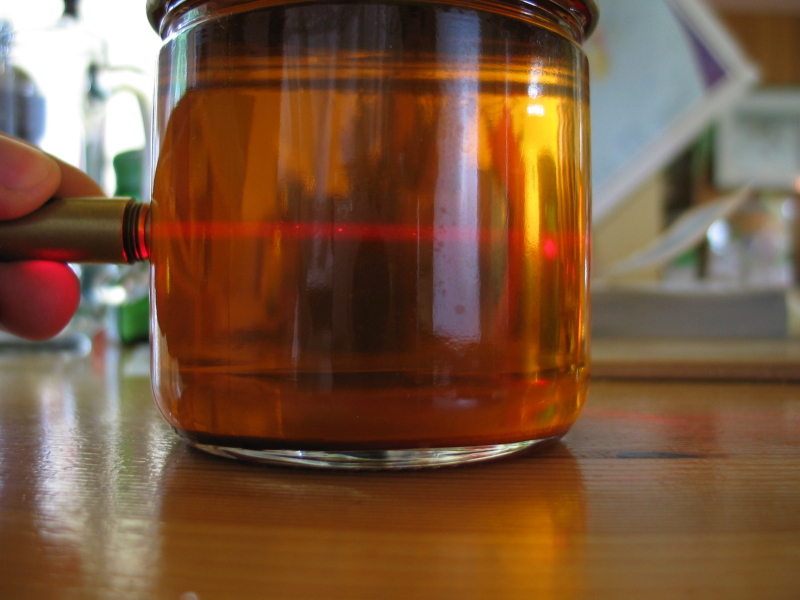

And here's shots comparing the oils with a laser pointer:
Pure Canola
Settling cold for 2 months
Settling cold for 1 month
Pumped through 30u -> 10u absolute SS filter
