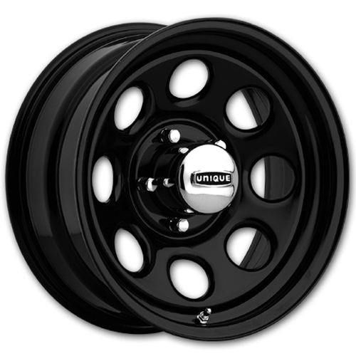

Jesse covered rim sizes without flares, but I have the standard stock flares and wanted to know
what size rim in 15x7 below would give me a proper offset for a wider stance but relatively flush
with the flares. Would 15x8's rub on anything?
I am looking to run 30x9.5x15 AT's as I am looking for a larger look, but I do not wish to remove/cut anything.
Thanks in advance.
Joe
Unique Series 297
Black "SOFT-8" Steel Wheel RWD
PART No. NEW PART No. RIM SIZE BOLT CIRLCE OFFSET (+/-)MM BACKSIDE SETTING SHPG. WT. CENTER BORE LOAD RATING
297-5712 1529544014B 15x7 5-4.5 0 4" 25 3.3000 2200

Joe,
Mine are 15x8 rims with 3.75" backspacing, pushing out the tire to the outside quite a bit.
With 31x10.5's on, the full tire sits 1.75" past the body.
I measured it out and the common flares you see would be perfect for this offset.
If you are running 30x9.5's and would like the same offset, then you would look for a 15x7 rim with backspacing of 2.5 or 3 " inches.
30x9.5 wide tires will not fit on a 15x8 wide rim. The bead will not sit properly. 15x7 is perfect.
This will push the 15x7 rim outwards similar to mine and will be perfect for those flares.
You may need to trim a 'touch' off the inside on the fronts, but other than that, you should be fine.
I measured the rear flares and you won't have to do any trimming there at all.
Running 30's, maybe nothing on the fronts as well.
The flares I'm referring to are on Mardy's van and the one's you see on most Delica's that have them.
Jesse
