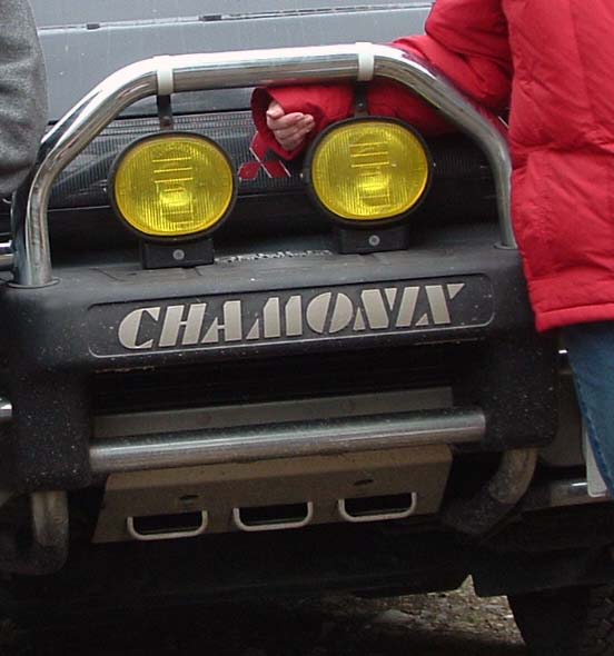

Hey folks, haven't named my van yet(shaggin wagin seems on the list) but what I am wondering is the skid plate issue......Is there any reason that people are not taking a template off the bash plate on a lot of the Chamonix? You wouldn't be restricted to that exact shape, you could cut the shape as you see fit.....Was just wondering.

because it doesn't do what we want...
The factory bash plate doesn't extend back far enough to offer any protection to the vulnerable radiator.

I think others are concerned about the opening, or air ram/vent, located between the upper and lower front skid plates. I haven't had the right wind fall take a stab at mine yet, knowing it won't stop a thick length wood; but hopefully will deflect it or give me enough time to hit the brakes.

I do understand that and agree. What I am thinking is extend the template to cover and louvre the extension. Then if need be you could add a heavier gauge wire mesh in the vented holes.....maybe be an idea, I'll give it a shot and see what I can come up with! I have yet to get under mine and take a good look, is there any way to close the area off and then have an external cool air intake and a hot exhaust of some sort? May have been a better idea to just have the engine oil cooled to begin with,but I'll let greater minds than mine figure that one out.........Cheers!

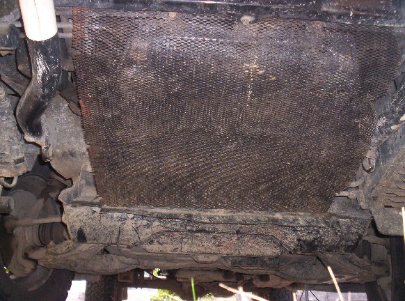

Mine is just made of the toughest expanded metal mesh I could fine locally and attached with the existing bolts using big washer to hold on.
