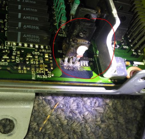

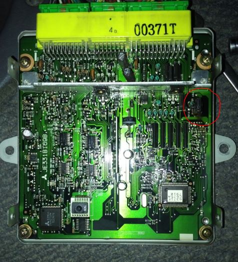

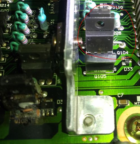

Ahoy, anyone out there with a 97 (gen 2) L400 able to tell me what the part number on ECU component Q102 is? It's the same package size as Q104 (Hitachi K1766) but, I'm not 100% certain that they'll be the same part (although often they are).
This is a MOSFET diode for controlling the glow plug relay. As you can see from the photos, the diode is blown so I can't see what the part number is.
Back story synopsis: my glow plug relay went, and when I replaced it I didn't get it grounded properly so when I went to start it up it over-drove and cooked said component.

photos of ECU with diode Q102 circled
blown diode Q102, damage is obvious
neighboring diode Q104 with the same package size as Q102 with hardware part number visible
