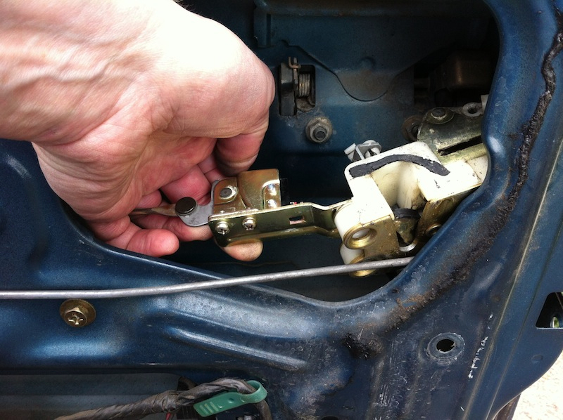

Last winter, my door locks started jumping up and down. Not very often, just from time to time I'd be driving along and they'd go *CLICK*. Okay, something up with that. Then a couple of weeks ago, I came back to the parked van, and the driver's door was locked, but the two on the other side were not. Okay, the door lock switch isn't working anymore. Here's the repair...

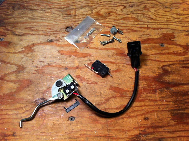

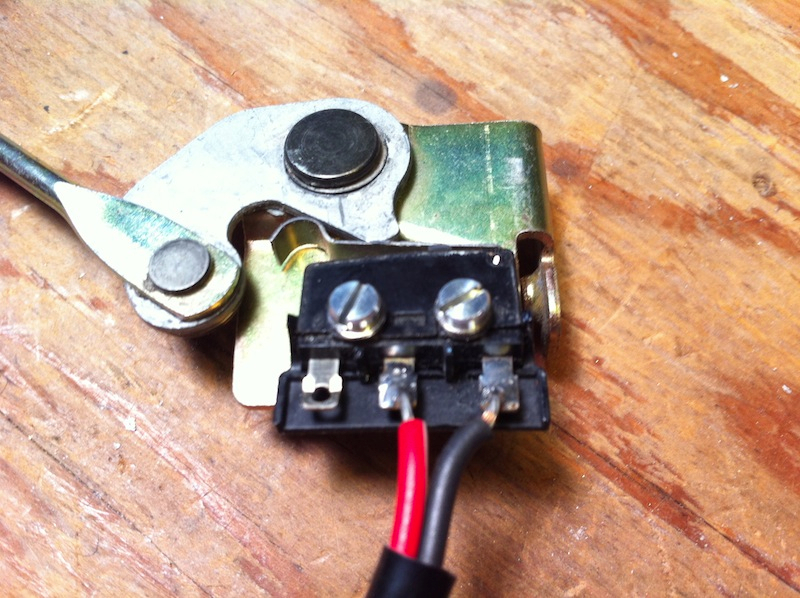

So I removed the door panel, peeled the plastic back, unclipped the pushrods from the actuator, yada yada yada, you can figure that out. Here's the switch on the work bench:

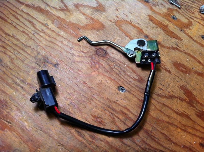

It's a microswitch, and I had a couple on hand, but they're physically much different from the original, so I decided to take apart and clean the contacts of the switch. You can see I've already pulled off the little plastic flash guard next to the wires.

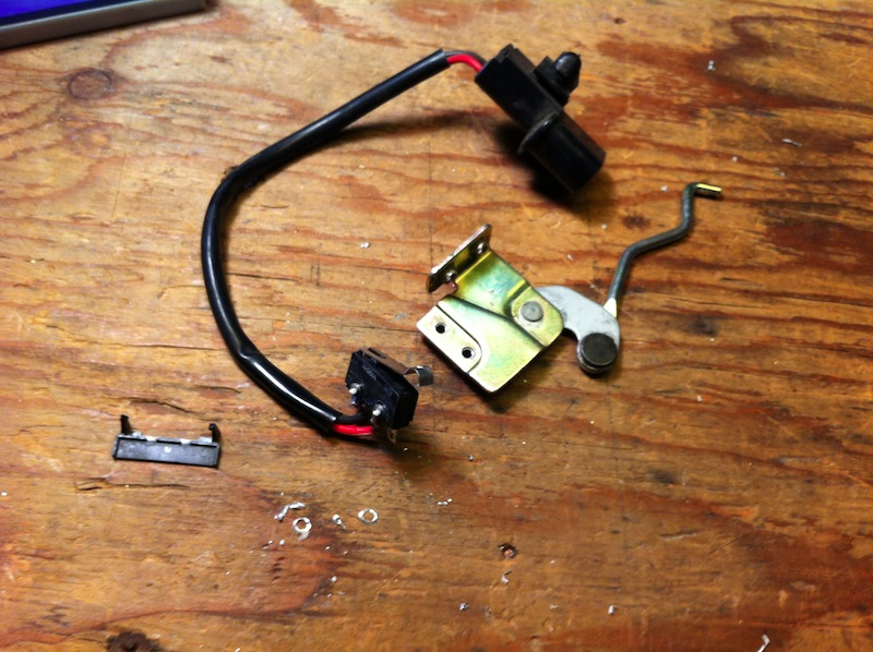

I drilled out the rivets holding the switch to the actuator bracket. I had to drill the holes in the switch and the bracket slightly larger to fit the bolts that would replace the rivets when reassembling. (darn those Japanese and their metric sizes...)

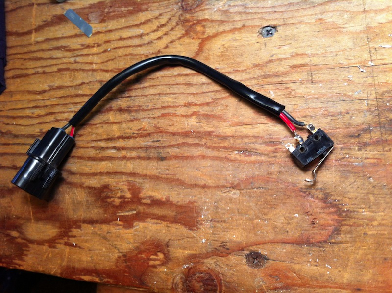

Heres the switch, all by itself.
Sorry, I forgot to take a picture of the switch taken apart, so you could see the insides and the contacts I cleaned. Anyway, I pried the plastic cover off, it popped right open, and there's copper contacts inside. And a little black plastic piece that will get lost in the shag carpet if you're not careful.
Here's the switch mounted back on the actuator bracket, with the little bolts. I think they were salvaged from a piece of computer equipment.
A close-up of my handiwork. Important to note: I trimmed the bolts with a Dremel, so that none would stick out past the nuts. This is important, as we'll see in a moment.

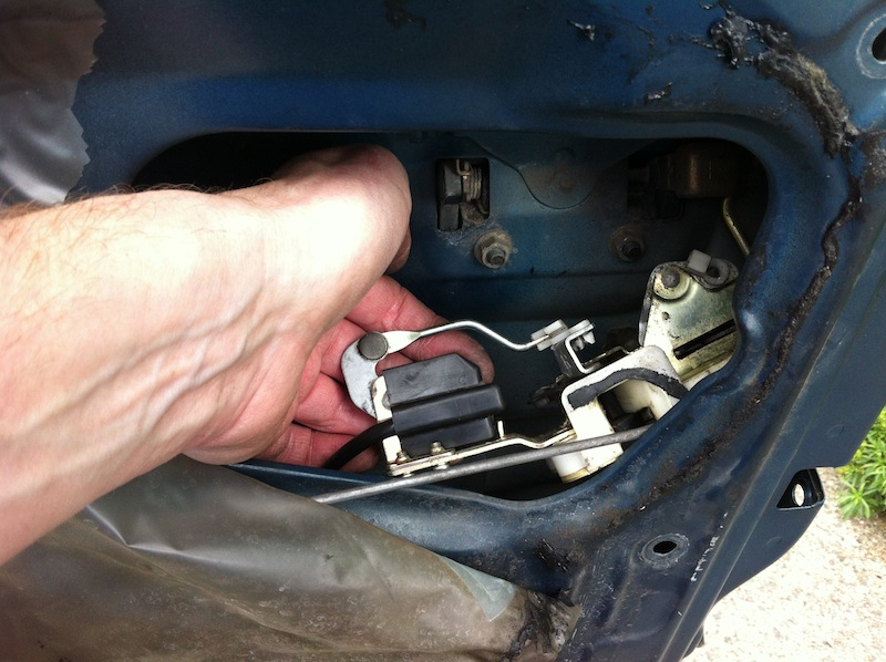

And put it all back in the door:
Then, as I was cleaning up my tools, patting myself on the back for a job well done, I realized I hadn't put the plastic cover over the switch. So I took it out of the door again.
This is the importance of trimming the bolts: the plastic cover has to fit over them, and the rivets are nearly flush. Presumably the plastic cover helps keep moisture out of the switch, so it takes 30 years before your locks get jumpy, and you need to clean the switch.
