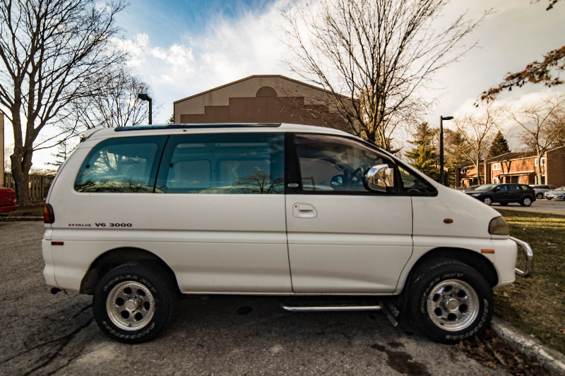

Hello everyone!
This is my first post. I've been lurking around here, but have yet to pipe up. I finally, however, bought a 1996 Delica Space Gear (super exceed gasser) and now have some questions. I'm really excited, but some things came up during the Ontario-required safety inspection that need to be addressed and there aren't a whole lot of resources down here in SW Ontario to do so. I need new brakes all around. Calipers, rotors, and pads. I've searched the forums and elsewhere online and here's what I have hesitantly concluded (please correct anything I'm getting wrong to help out a newb before I order some parts! many thanks!):
- It's my understanding that most of the brake components made for the Montero (does it need to be a 95 or match the equivalent year? does it matter whether it's the 3.0 or 3.5?) should work ... well, calipers, pads, and rotors for the rear at least.
- I'm not as confident about the front rotors. Will the Montero version work? If not, did you have to order delica-specific ones?
- Okay ... next question: apparently this vehicle also needs a steering shaft. Any chance a Montero version also works for this? If not, anyone know of a good place to begin looking for one for the delica? Also, has anyone done this? If so, was it a difficult fix?
Any help would be greatly appreciated. I'm dying to get some parts and get BB Yeti on the road.
