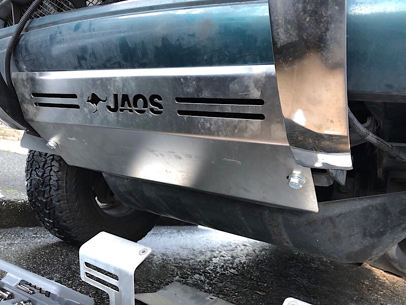

I have purchased a set of 2nd hand JAOS bash plates but I can’t figure out how/where the second piece fits under the Delica. Anyone seen this configuration before?

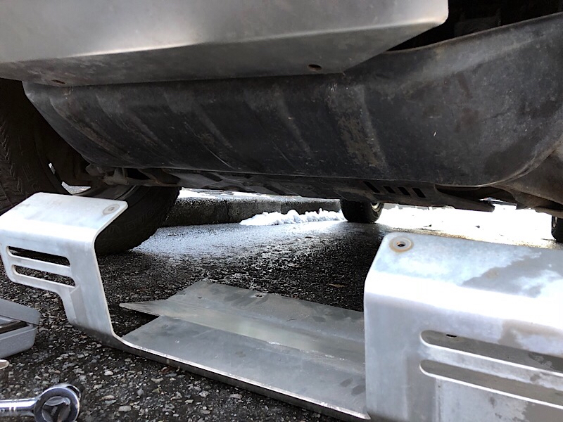

The first piece replaces the original plastic bash plate and fits nicely with my JAOS bull bar. The second piece has pads on the inner sides of the squared fingers as if they were meant to prevent scratching of plastic pieces but it doesn’t seem to fit over the front or rear bumper so no clue where this fits.

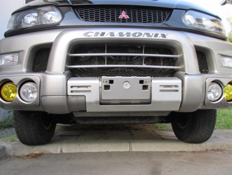

Found the answer from Shogo at Japanoid...the second bash plate is a Mitsubishi original part for Series 2 L400’s. Mystery solved.
