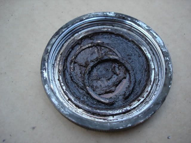

I'm currently in the process of rebuilding my front hubs (auto locks and F&R bearings) because mine got some serious grief on the last off-roading weekend.
On one tricky part climbing some wet rocks on a steep hill, my front hub gave out a really loud CRACK! Over the following 1,000 miles the front hub started getting noisier to the point the other day when I started to hear loud clunking!
I was only 1/2 mile from home so I drove back and started stripping the hubs down. I took the cap off the hub and the first thing I noticed was all the brown gunk/gravel in there!!! Somewhere the seal must have given way allowing mud & dirt into the hubs.
On the inside of the cap I saw the circlip/snap ring that should have been holding the driveshaft in the hub. With this off the hub, the driveshaft can move back & forth allowing dirt into the hub....

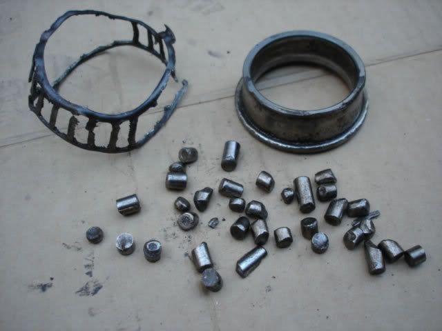

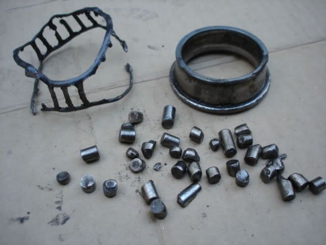

.....and as I removed the auto lock (full of gunk and unidentifiable debris) and bearing plates things got a LOT worse!
This was the remains of the front bearing (after being washed in white spirit) and is exactly how it looked when I removed it - albeit a lot cleaner!
Obviously all the noise was caused by the gravel in the hub....and the clunking was the bearing breaking down! Luckily most of the damage seems to have occured close to home and I am currently pulling the bearings out of my L400 (which I am parting out) to see if they will fit the L300....

O U C H ! ! ! !
Some of the round-like things weren't so much any more... no wonder it was making that 'weird' noise.

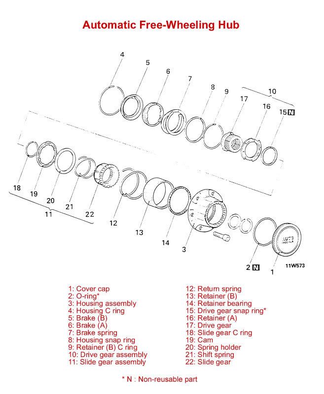

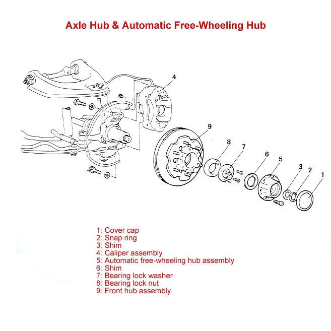

Thanks Dude - appreciate your comments!jrman wrote:Bruce...you've got the best diagrams / photos out there.
I've started my own archive of these...may I never have to use them!
They are genuine Mitsy diagrams that I photograph, then bleach out the 'paper' colour, adjust the contrast and add my own text to make them nicer to view. Each one takes about half hour to do but I reckon they are worth it. It's enjoyable to do - but with over 8,000 diagrams here in my study, I doubt I'll be getting them all done sometime soon!
Rdub,
Here are some more diagrams that I did for you this morning...
I've got some more for you to help you out - along with some technical info, but won't have time in the next few days because I've got a big contract to finish (should be on it now, but this is more fun!)
I'll also have some 'hands on' info after the weekend when I strip down and rebuild my front hubs/brakes etc....
