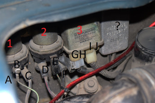

Hmm. Is the bypass activating the super-quick relay (the rightmost of the two round relays, thin wire connected by a spade terminal, labelled "2" in the picture), or the slow relay (the leftmost one, thin wire connected to a small screw eye, "1" in picture)?
If you hold on the quick one for too long, you'll burn out the glow plugs. They're 6V plugs, and the right relay feeds them 12V to heat them up quickly, but only for a short while. The left relay feeds them 6V (through the resistor pack labelled "?") to help the engine run smoothly while it warms up. If your bypass switch activates the slow relay, it'll take quite a while to heat up the glowplugs.

Growlerbearnz wrote:Hmm. Is the bypass activating the super-quick relay (the rightmost of the two round relays, thin wire connected by a spade terminal, labelled "2" in the picture), or the slow relay (the leftmost one, thin wire connected to a small screw eye, "1" in picture)?

I guess it's behind this air pipe right above the air filter housing :p
Is this the Accepted Amount of Smoke when Starting? (video)
Yup, you have to remove the upper intake pipe to see the relays (as in the photo a few posts back). It's retained by one 10mm bolt into the B-pillar.

Also, I too have a bypass button on my steering column. I bought the van in Idaho a few weeks ago (cold, cold, cold) and was able to start it. The guy I bought if from instructed me to hold it down for 10 sec or so before starting the engine. I can't remember if I heard clicks or not, but I was able to start it (albeit somewhat roughly) and drove it over here to Seattle. I don't currently hear a click when I push the button and it's having trouble starting right now even at 45 degrees F, behaving similarly to what I see in your video. I checked the relays and I see a yellow wire patched into the furthermost left relay (number 1 in Growlerbearnz' photo which should make it the 6v relay). I follow the wire and it dead ends into the dashboard up front, just hanging there, not connected to anything.
Which relay do you have bypassed, and what does the wire attach to?

The dangling wire comes off of your glow plug bypass switch, which is why it's not working now. With it attached to the 6v relay you might need to hold it for 20-30 seconds in cold temps. If you move it over to the 12v relay you shouldn't hold it for more than ~6 seconds, but in cold weather you may need to cycle it every few seconds during the startwarm up.
