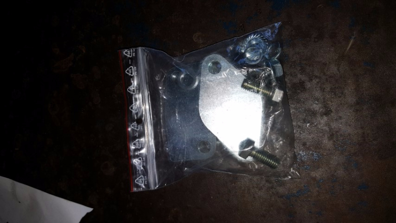

Step one: Buy your kit! EBAY!!

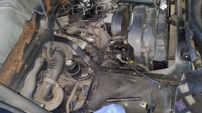

Step two: Prepare for removal. Remove driver's side subfloor section (removal of this can be found on another thread)

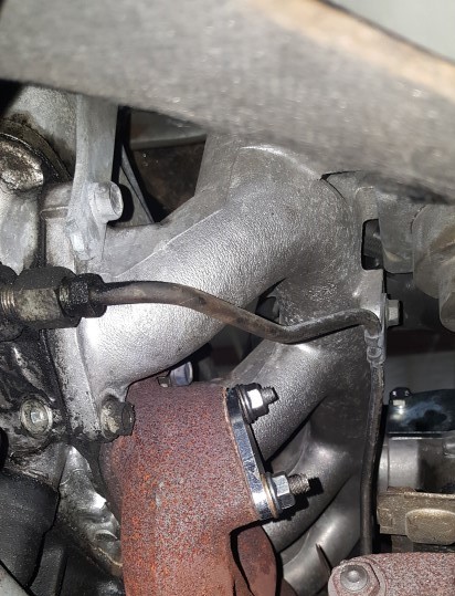

Step Three: Locate the enemy. This is the EGR Valve itself. It attaches itself with two 12mm bolts to the intake manifold. It has a metal pipe that connects down to the exhaust manifold with two 12mm nuts. Remove the vacuum line from the EGR Valve and install the supplied vacuum cap to the metal line that originally provided vacuum to the valve. Spray everything with WD40 and wait 30 minutes. Now remove the 12mm bolts up top and the 12mm nuts below. Snake the EGR Valve and pipe out as an assembly. Do not try and remove the pipe from the EGR Valve in the truck; it is unnecessary. Removing the nuts on the manifold may take the thread studs with you. This is because the nut has siezed itself to the stud as a result of heat. I had a spare set of studs laying around; you may not be so lucky.
Step Four: Install the blockoff plate at the intake manifold and at the exhaust manifold using the supplied hardware. I used a small amount of RTV on the intake manifold to ensure a good seal. A leak here will sacrifice performance and make a mess as it will drip down onto the turbo.
