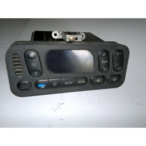

The climate controls on my L400...
...don't seem to control the climate very well. Specifically, the fan setting seems to change of its own free will. More specifically, when it's on full, it usually is more like someone exhaling constantly than an actual fan. Every once in a while, it kicks in full power, but only for a while, and then changes its mind again. It's almost as if changing the fan setting changes the maximum that the fan can go to, but doesn't necessarily set to the fan to that speed.

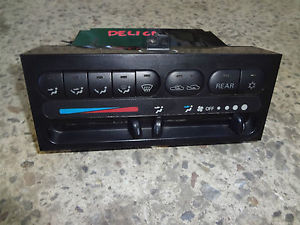

Thoughts? Ideas? Would I benefit from switching to these bad boys?

Have you checked that the "Auto" is not engaged?  This may explain why the CCU seems to have a mind of it's own.

Yeah, I much prefer to set the controls myself, so I keep 'Auto' off. Not a bad idea to check, though. Maybe it comes on automatically unless you specifically disengage it?
Does anyone know how big of an issue it would be to switch form one set of controls to the other? The 'convenience' of the digital setup doesn't seem to be worth it, at least in this case.

My buddys L400 has the same as your controls and he's always complaining about them, My S2 has controls like you posted and they're great. However, I don't believe it's a straight across swap, your vehicle will have more servos I'd imagine
sorry to thread jack, but if anyone has an extra rear HVAC unit and controls I'll take them off your hands.

Like I said, I highly doubt its a straight across swap. Just by comparing the two controls, the temp mixing valve with be servo controlled, so you'll need that servo, and whatever associated ECU it requires.
It will also most likely require most of the dash coming apart.
And when it comes to taking apart the dash, aside from the middle console being relatively easy, for the rest, it almost all has to come out from side to side.
