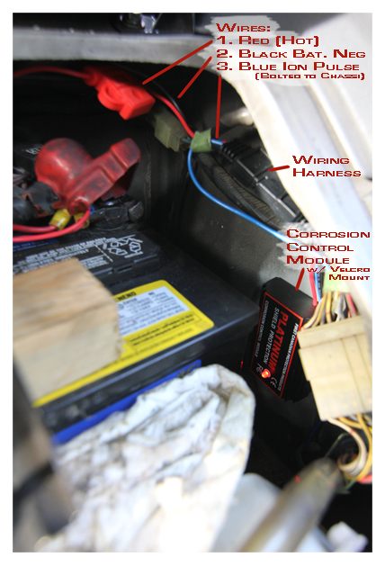

Installation was easy. The module mounts via Velcro with adhesive backing. Included in the kit was a alcohol wipe to clean the surface prior to mounting the adhesive Velcro pad to body. I used a spot of diesel on a cloth then followed with the alcohol wipe for a truly clean area. The photo shows the cleaned area.
The wiring harness fits tight and proved to be a hassle if needed to disconnect within the small space of the battery compartment. I instead of risking busted knuckles, I lubed the connectors up with some dielectric grease, which proved to help ease of disconnection.

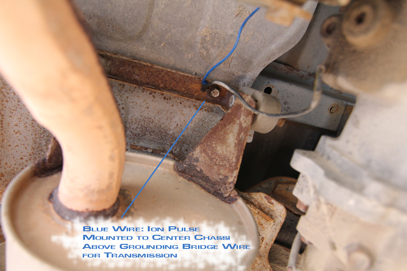

The three wires were mounted easily; Black to Battery Negative, Red to Battery Positive, and Blue at least four feet from the module on the chassis. I used the full length of the wire provided as it was just enough to reach the exhaust bracket and grounding wire for the transmission near centre of the Delica L300.
I made sure to sand down the surfaces of the places I was connecting my wires and used a little dielectric grease for added protection. I ran the blue wire from the battery compartment down along the coolant overflow hose, then along a cable underneath towards vehicle centre. I then mounted the Blue wire above, or first before, the grounding wire for the transmission thinking it may be better for dispersion of ions and and less chance of complications. I like this area for it is close to centre, used the full length of provided wire, met the minimum of distance from module and as a bonus intersected the exhaust bracket, transmission and chassis/body of the Van. In the future I may connect a wire to meet the exhaust system to unsure extra protection seeing most of it hangs free by rubber hangers.

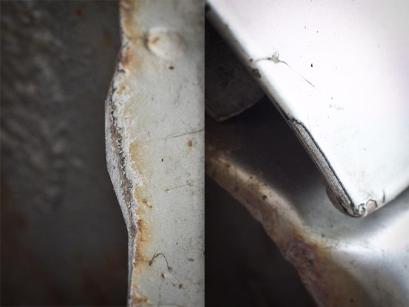

So, these are from day one of sanding down to bare metal. I sanded two places; one is on the passenger side fender behind the tire on the spot welded seam where there is existing surface rust, the other is on the corner of the passenger door of no rust. I chose the door seeing the current has to travel through all the connections fastening the door, then down to the bottom corner, plus these two places are easy to monitor daily. So, far it's been a couple of days since I had taken these photos and nothing has changed. I'm excited to check back in a week, after of being parked at an airport as I am away for training.

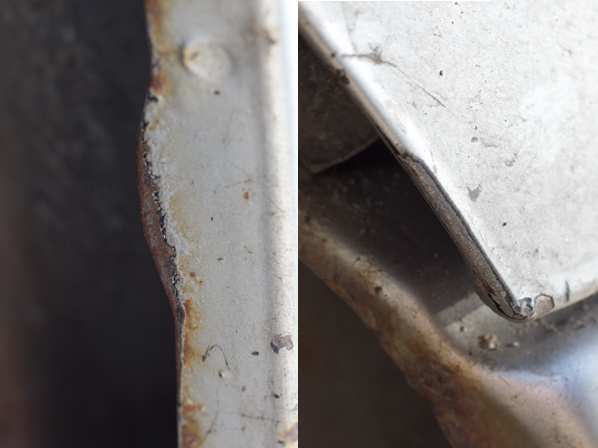

These are the photos taken two weeks later since sanding down to bare metal. It appears the door hasn't changed a bit where as the area where corrosion already existed has stained some. I'll keep monitoring and see what will occur in months from now.
