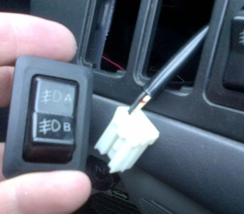

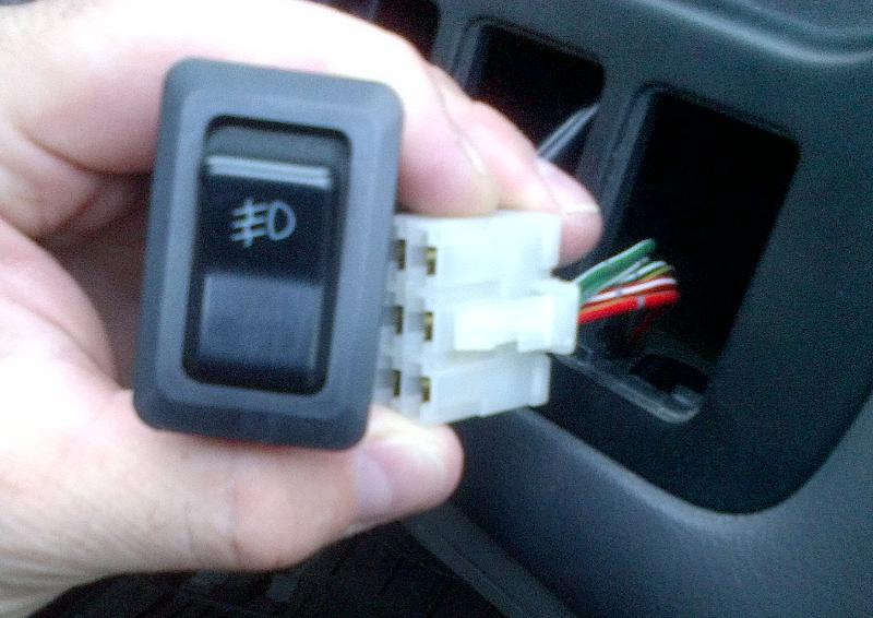

Mystery plugs...Well not so mysterious!
The L400 sometimes have a dual switch for the accessory lights.
The main power switch is the 6-contact unit you photographed. There is power for the lights amd power for the small indicator bulb that comes on with the dash lights.
The second 2-wire switch in my Deli acts on a relay and allows me to switch between 2 sets of grill guard lights. This switch doesn't light up at all.
