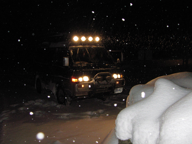

Bridgestone Blizzaks, 235/75-15
Photo taken near Nakusp Hot Springs last year in about 3" of fresh snow.
- IMG_4564sm.jpg (119.74 KiB) Viewed 11361 times
