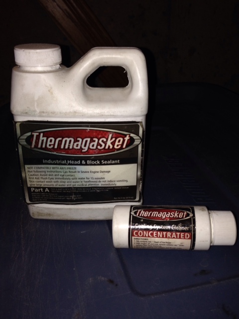

Just a reminder. This isn't something I just read up on and thought cool.
It's something we did to the crappy 2L-TE motor in the Surf. It's the one
your supposed to avoid like the plague. If it were a zombie world outside,
this would be the only vehicle you could find with keys in it , while
being chased by those 'Running Zombies' You would be better off
running.
It fixed a majorly crapped out engine. And that was a long time ago.
And my friend still hasn't learned to not overdo it.
We still have another dose since they give ample of the stuff.
And when my buddy blows it up again. We will do it again. That's how
we feel about this stuff.
To get at the thermostat (I was reading up the other day) it is a bit
of a pain since the location is at the lower hose.
http://www.delica.ca/forum/thermostat-i ... tml#p34220
1. Drain coolant off rad and engine block. 14mm nut located on exhaust side of block.
2. Remove driver seat and engine cover.
3. Remove power steering pump.
4. Remove lower rad hose connected to thermostat hsg.
5. Remove and install thermostat.
The power steering pump only has to be undone and moved out of the way
You don't have to remove any hoses.
So do above. Put it back together (leaving the bash plates off) and
I would leave the seat off. Fill it with water, drain water, fill again.
Add the stuff and follow directions.
It will take you an afternoon. It's not as bad as removing the alternator.
Maybe another deliowner could give you a hand if there is anyone in the
vicinity and a 6pack of beer.
Another way of looking at it is that you can get through the winter feeling
out your options till spring and spend the money for a big fix then.
Or decide you feel comfortable with the current.
I included a pic of the leftover stuff I have to show you Im not feeding
you a bunch of bull (that we did it)

I don't doubt your results at all. I spoke with my cousin about it (I'm trying to find out about others' experiences as well). He says he's seen this used and used it himself on many vehicles. He told me the fix could last anywhere from weeks to years. Also, if you try using it again, it will keep building up layers and each time it fails will be worse. I really don't want to have to deal with this again, or have it come up at an in-opportune time. That thermostat removal doesn't sound too difficult, but I'm not sure when I'll have time for that even.
