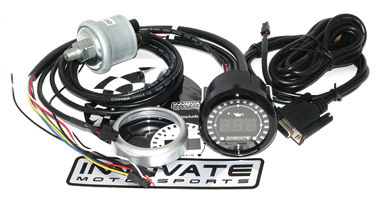

So, I have the sandwich and remote oil filter set for my L400. I also picked up a mtx-d oil pressure & temperature gauge (as well as a RHD gauge pillar pod).
I was looking through the install directions for the MTX-D oil pressure gauge, and there is a warning not to put the pressure sender too near the oil pump as the pulsations from the pump can damage the sender. I noticed that the oil pressure sender that is stock on the 4M40 is quite some distance away from the pump - near the intercooler in fact.
Which brings me to an isolator.
Now, normally, when you use an isolator, it is to keep stuff like fuel from leaking into the cab when you are measuring fuel pressure with a gauge. In this case, I don't need the fluid separation, I only need to "isolate" the pressure sender.
Can I go about this with a long oil pressure line? Would that work? Should I use brake line instead of braided steel and rubber to isolate the pressure sender? How far would be enough?
Or, should I just tee into the same area as the pressure sender with the stock location? (That leaves an unused port on my sandwich.)
The Pressure Gauge and bits:

The installation guide for the oil gauge warns you not to put the pressure sender right nest to the pump. Unfortunately, that was my plan. I have an oil sandwich that is set up for the sender to go right into. But this is probably only 3 inches away from the pump. So, in this case I am looking to "isolate" the sender by adding a longer line, not to keep fluid out of the cab. I could tee in where the stock oil sender is, but I did get the sandwich with oil temp/pressure/bypass in mind.
So, basically, I am trying to figure out where to mount the sender, when I had intended to put in next to the pump, but the directions warn not to do this.
