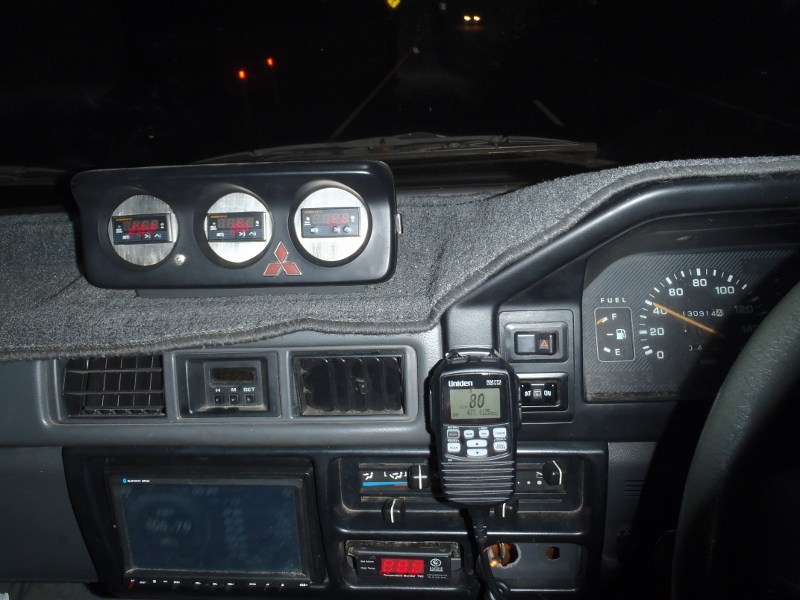

I have installed a coolant sensor in my top radiator hose and an engine watchdog sensor attatched to a side bolt on the head along with the factory temp gauge .The watchdog will always be the the first to pick up true changes in engine temps as it measures the metal .The hose sensor will follow shortly after but the factory gauge is not to noticable in 1 or 2 degree changes. For a guide my coolant has gotten up to 100deg ,watchdog 106deg and factory gauge sat at half way
P2060036 (800x600).jpg (237.72 KiB) Viewed 6219 times
