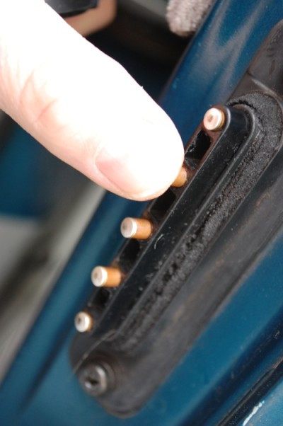

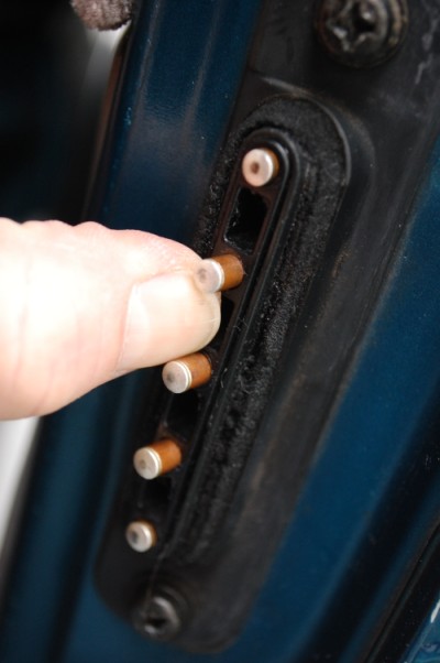

Clean the electrical contacts on the B pillar for he sliding door. Steel wool, scotch bright pad works nicely for removing light corrosion. The contacts are operate the self closing catch for the slider door.
Check the catch mechanisms in the door and see if they are open wide. Pushing a screw driver into the catch is the best way to check for proper mechanical movement and engagement. The catch should close around the screw driver end.
Dirt/Moisture will make the catch stick and prevent proper engagement. Spraying the mechanism with Brake Cleaner will clean the greasy debris, relube with a lithium grease spray and then operate the door a few times to get the lube into the mechanisms nooks/crannys.

The BB is right. I had a problem with my auto-lock mechanism not working on the slider - the contacts on the B pillar and the mating piece on the door itself were cruddy.
I would only add to check that the spring loaded mechanism on the door part is moving as it should. Mine was ceased, and as a result the contacts weren't contacting. I wiggled it free, and followed up with some vaseline - not sure if this is a good idea, but it seems to have done the trick.
