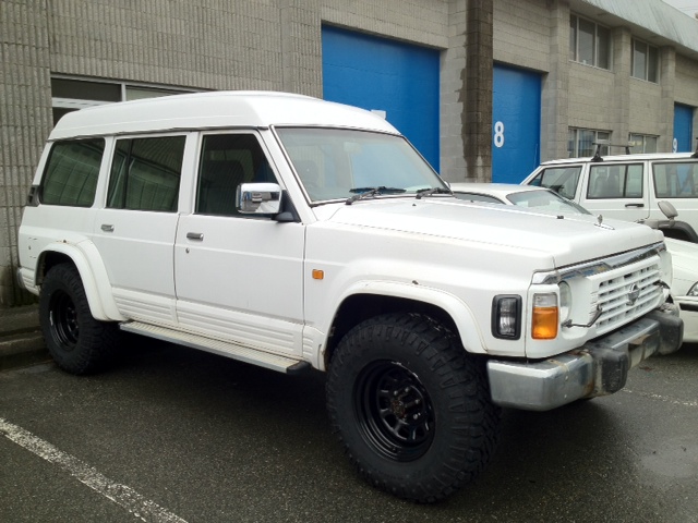

Fresh boots, brakes and fluids.
Suspension lift kit on it's way.
Fluid changes are fun.
Engine - 12.5L
Coolant - 14.5L
Transmission/tcase - 11L
Diff - 5.9L
chrome is disappearing slowly and being replaced by Mr. Satin Black 8-)
Purrs like a kitten delica-L400-esque. Soft idle until you hammer the throttle. Turbo pickup is smooth. All in all, an enjoyable JDM project rig to work on similar to Turtle.

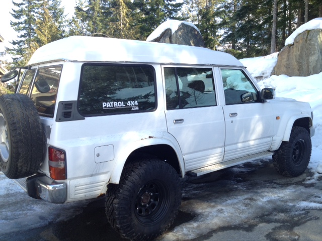

Re: jfarsang's new ride the 'White Elephant'

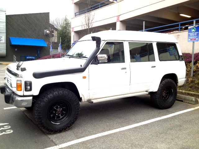

shed most of the chrome bits
snorkel added
injectors re&re
seafoam IP treatment
2" OME lift installed w/ procomp 9000 shocks
Ride is much better. Not harsh as I had anticipated with HD coils.

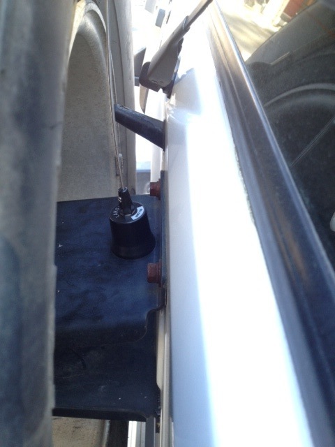

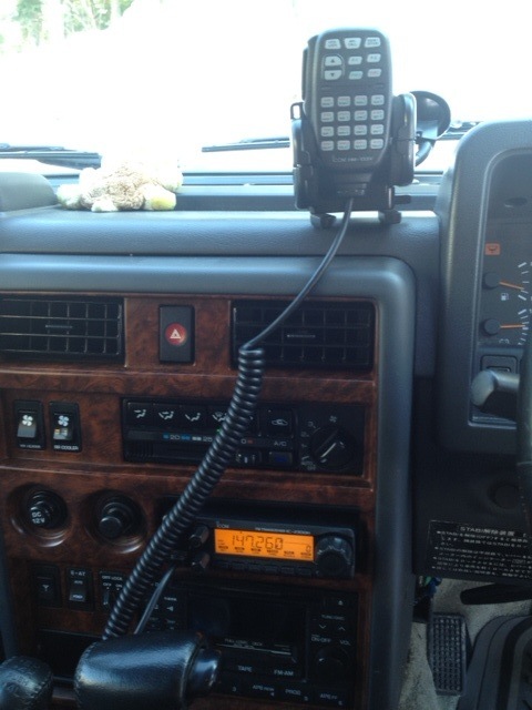

The elusive Jay worked his magic on installation of 2M antenna and Icom IC-2300H radio.
Fitment was slick. The unit slipped right into the stock ashtray location.
Was able to hit NSR from function in whistler. Good range.

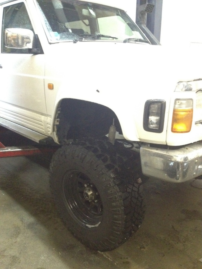

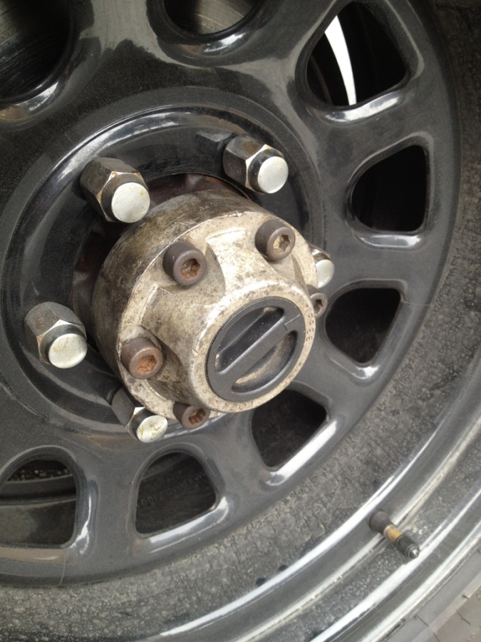

Front procomp shocks fitted.
A lot more downtravel than I had anticipated (good thing). Need to grab 1/2" springs spacers to compensate for the springs dropping down.
Manual hubs fitted (my auto's self destructed)

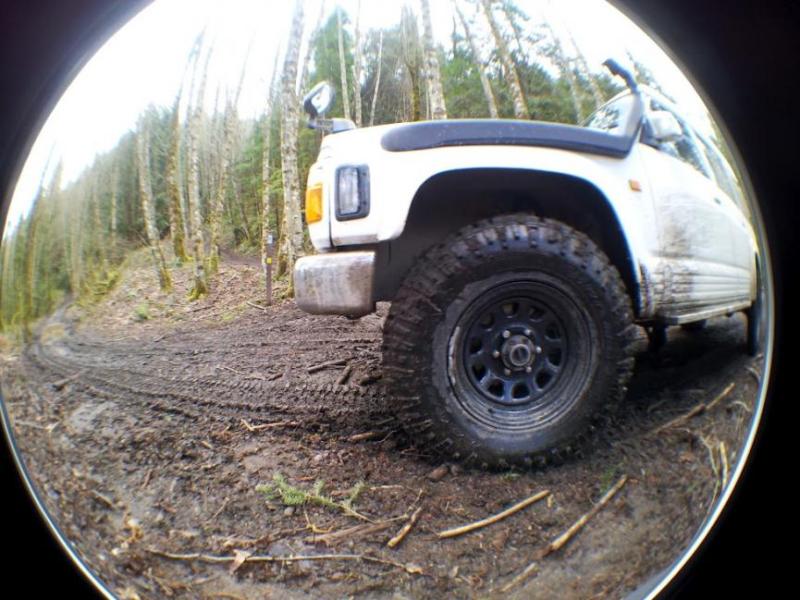

Hopefully this weekend at Chilliwack or Stave Lake area. 4-5 Safari's playing around.
Mud & Snow. If you look closely, you'll see the marker for advanced ATV trail.

Hey shealy. You're correct. They were ATV marked trails up on Vedder Mtn. Fun day out. 8-)

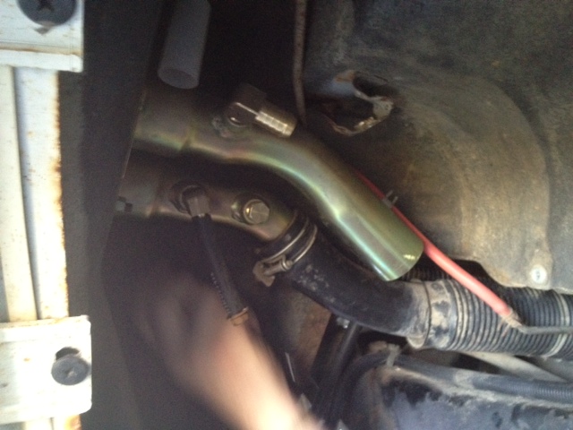

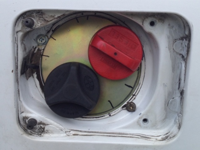

Dual filler installed for 2nd auxiliary tank (mounts under the frame/driver's side underneath the rear passenger area)
Didn't think it would fit but it did.
Now the fun part. Routing the 1 1/2" thick fuel hose. Last time it took David, Jay and myself all three of us pulling and wiggling it through. I was hoping it was a one time deal. Now, it appears it will have to be done .. again. :-D
