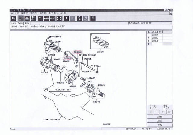

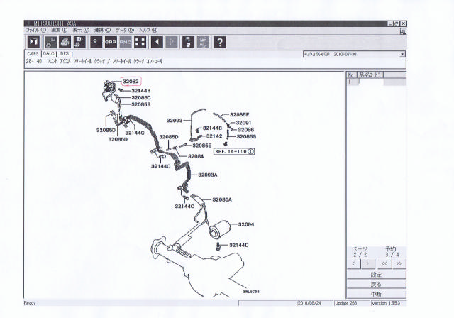

Hi... trouble with the vac solenoid switch actuating the 4WD circuit. You may need to replace them to solve that issue.

it will be just a solinoid issue.
and your problem is gone.
