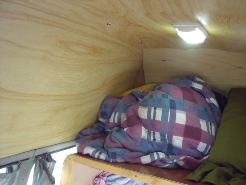

Re: Vote for Hitop VS Poptop - PHOTOS of new roof on Delica
Few shots of the interior.....
Looks great !
Any plans for windows ?
