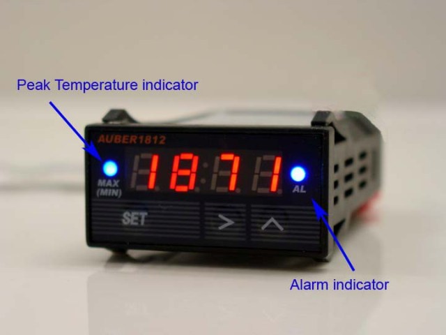

So... the Glowshift pyrometer I bought was crap. It died in a month. I could probably get a replacement for free, but I disliked it so much I wanted to change anyway. The main problem was that the temperature display was way too small, and it reflected so much light that I had to shade it with my hand to read the temp. It was a distraction.
So I ordered this: http://www.auberins.com/index.php?main_ ... ucts_id=19
1812 web.jpg (36.1 KiB) Viewed 7204 times
What I like about it, besides the display being a nice size, is that it has logic and can record peaks (over last 100 hours) and supports an alarm. Also, the price. Its cheaper than most every one I've seen. And it supports my existing installed probe; just wire it up.
Will follow up with install photos soon...

So I picked up the new Auber Instruments unit today and roughed it in. Works with the existing thermocouple with no adjustments. Much more sensitive than the old gauge; I get temp readings right down to room temperature. The numeric display is about 1/2" tall which makes it easy to read, but the unit itself is quite small (that photo above is probably over double actual size). High quality terminals too. Really only good things to say all around.
I noticed it supports boost and other temp probes. Since it's so compact, I'm going to buy a couple more.
This is by far the best pyro available and its almost half the price of any of the others I've seen. Highly recommended.

RichD wrote:This is by far the best pyro available and its almost half the price of any of the others I've seen. Highly recommended.
Great alternative to the regular gauges! Let's see how it holds up over the time. I heard the same about the Autometer/Glowshift too, till a they died after a few month.
Great alternative to the regular gauges. Let's see how it holds up over the time. I heard the same about the Autometer too, till a few died after a few month.
That's why I moved away from automotive/retail grade and got one designed for industrial applications.
Richard Dagenais
