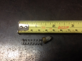

OMG so simple. I didn't even think of that screen because the, you know, *fuel filter* should be stopping any crap from the fuel, though I guess the screen's there for a reason.
I'm totally going to clean that screen on my IP. Just in case.

OMG indeed - so simple and why have a screen AFTER the fuel filter? That's why it was so hard to determine the problem. But apparently stuff gets to there so I'll be putting it back in shortly. I love learning stuff....the hard way! Ralph in Winnipeg

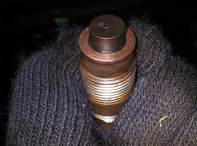

> There's one injector that looks a bit moist where it enters the head so I pulled that injector and gave it a bit of a cleaning. Nothing obvious visually. But for fun, here it is:

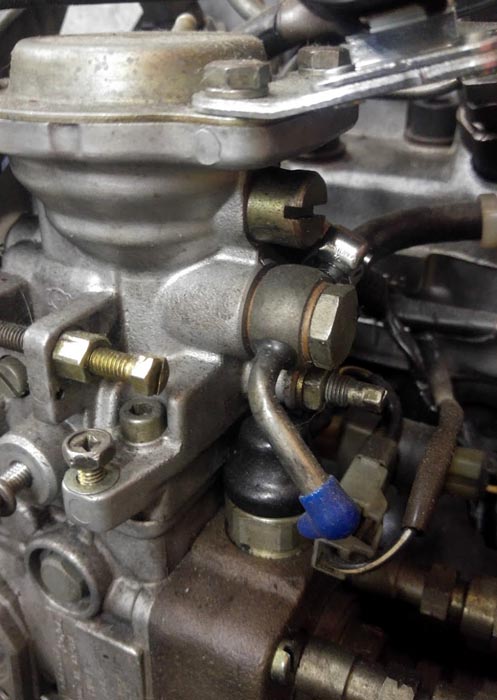

Hallelujah! Issues resolved! There was a hidden little screen in the fuel supply line right at the banjo fitting before the IP that was totally clogged. Such a simple thing and yet so hard to find! Truck is running better than ever, EGTs on the highway below 200C. Pretty relieved
Can someone post a picture-drawing of that area with an Arrow/Circle of some kind so we know where is Banjo Fitting ? I will give it a look :shock:

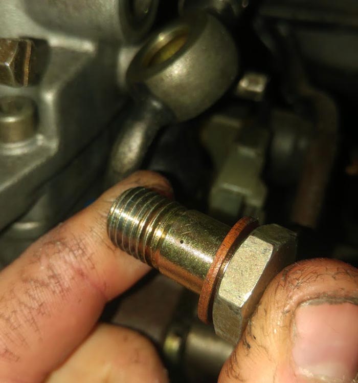

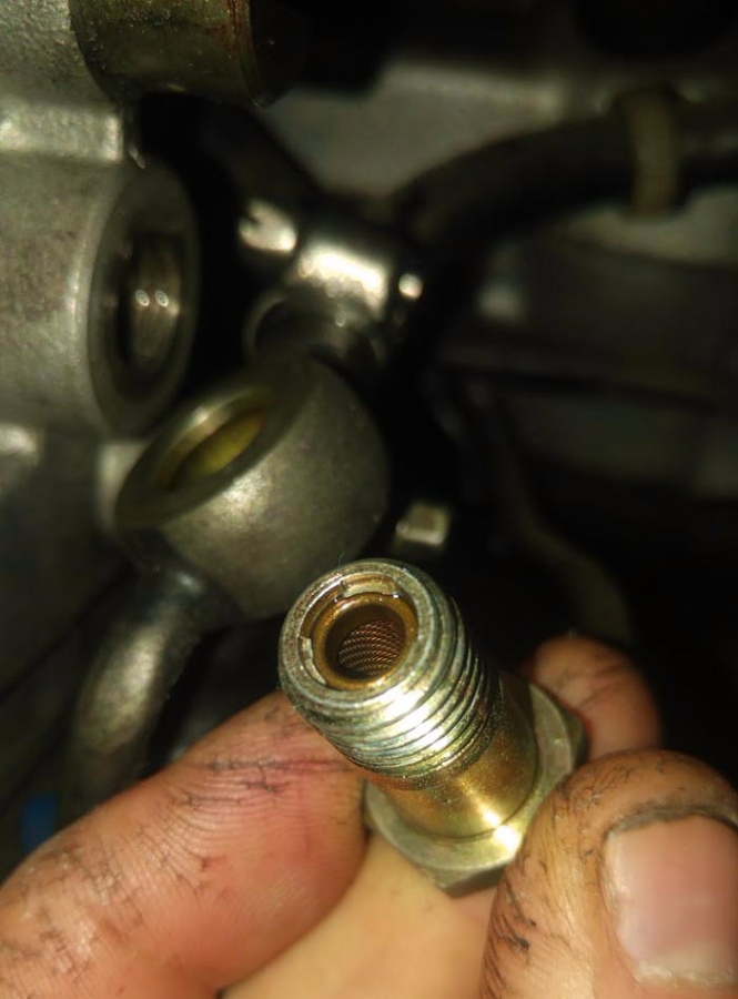

The screen you need to worry about is in the outlet banjo on the back of the IP (not pictured in the diagram above):
The outlet banjo has a tiny port, intended to restrict the flow of fuel so the injection pump is slightly pressurised. The injection pump uses that internal pressure to regulate the timing.
If the screen or port are clogged, internal pressure will rise, which changes the timing.
The screen on my pump doesn't appear to be removable, unlike Ralph's screen:
Ralph in Winnipeg wrote:
Here is the culprit. I'm thinking of putting it back in - it worked once and may need to stop some crap again. And now I know where it is.
If I had to clean it, I would apply compressed air to the restrictor port while aiming the screen end at a sheet of clean paper. That should shift anything that's in there, and let you see if anything comes out. If something comes out, I would flush the banjo with diesel and apply compressed air again- repeating until nothing came out.
