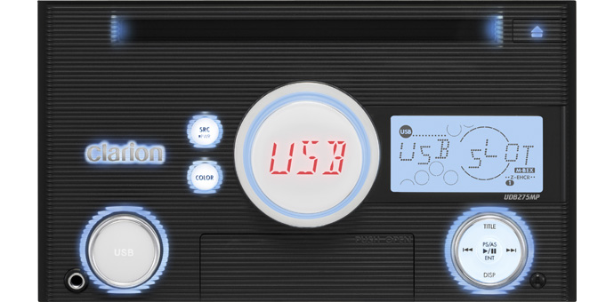

I installed this clarion 2-DIN system - it fits perfectly without the use of spacers or inserts. More info at http://www.clarion.com/us/en/products/2 ... 98489.html

Never seen this system before, looks nice AND very different then everything else (just like a Delica). :-D Like it! Did you end up paying $400 as per your link? Can you control your ipod through your radio or control your radio via the ipod? Well done anyway, always nice to see something different...

Thanks!! No - didn't pay $400 for the deck ($299 after some dealing) and with new 150 W speakers all around I was into it for more than that - but the sound quality was worth it. I was itching to get rid of the circa 1999 Japanese carrozzeria deck/TV... I saw one of these Clarion systems on ebay for $209, but am always a little suspicious of car audio on that site... The iPod links directly in via the usb charger. No radio control through iPod, and the Clarion takes the user setting directly from the iPod, so if random selection is on, that's what plays through the stereo. Can plug anything into it through the USB - jump drives, portable hard discs, laptops...This unit is way different than anything I have seen, which is what drew me to it. :-)
