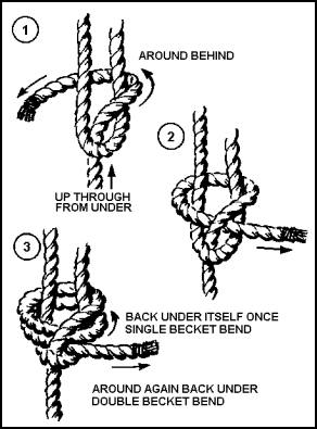

This one works great for joining two ropes of different diameters/construction, or even rope to cable, or rope to chain. Doing the double wrap (step 3 in the diagram) prevents the bend from potentially inverting on itself and coming undone.
. To tie a single sheet or becket bend (Figure 12-14), take a bight in the larger of the two lines. Using the smaller of the two lines, put its end up through the bight. Then put it around the standing part of the larger line first because it will have the strain on it and then around the end of the larger line. Next put the end of the smaller line under its standing part. The strain on the standing part will hold the end. Notice in the double sheet or becket bend that the end of the smaller line goes under its standing part both times.

Nice illustrations, JW. I have no clue what a "Trucker's Hitch" is. Does anyone else have pictures of these knots they are talking about?
