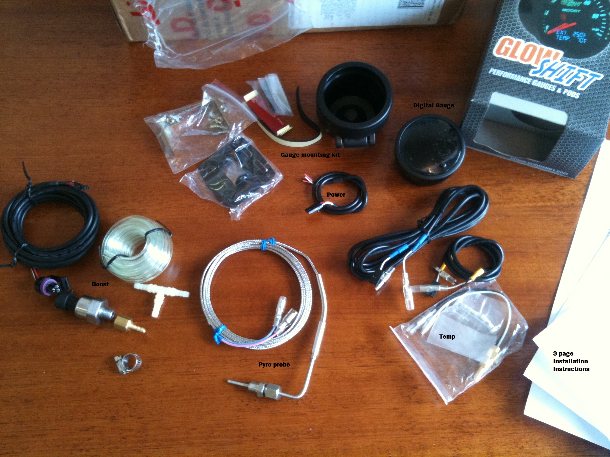

Received our new 3-in-1 combo gauge from GlowShift today.
It was 194.25 (Canadian) shipped plus the duty was another 37.34 - 231.59 total. Comparably, it was slightly cheaper than the Lordco kit which is only a pyro meter.

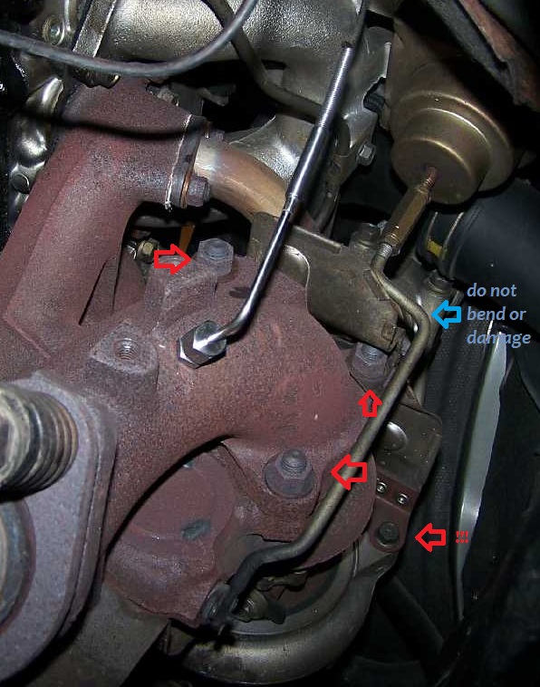

1) remove the short exhaust pipe below exhaust adapter (two spring loaded nuts, two bolts)
2) remove the exhaust adapter (note the smaller bolt on the top right which retains the heat shield; remove this one first; see photo)
- be considerate of the relatively delicate wastegate actuator. Bending or stressing this would be poor form
- its a fairly small space and a number of combinations of drives and extensions were handy.
- note which nuts go where and which had washers. Yeah, it matters
- as it comes loose, note the metal gasket. Don't mess that up, eh?
- it will take some wiggle to remove. You can pry a little here and there with care, but don't pry against the gasket!

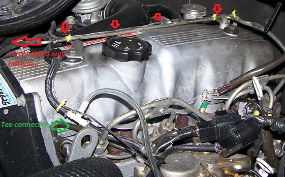

8) Take a look at the red arrows added to the photo below for a wiring route that makes a whole lotta sense (cheers, lrp374).
Boost probe:
This is super easy. See green arrow in photo above.

13) I routed my pyro sensor wiring up over the engine as lrp374 did but instead of veering left, I kept going straight (see big red arrow in photo above) through to the firewall under the driver's seat and down under the carpet to the left of the "footrest" where a clutch lever would be if I had one.

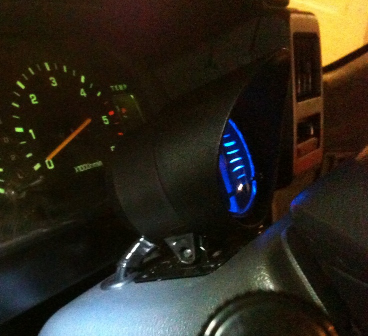

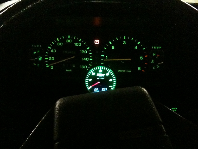

- I installed the gauge on my steering column as some others have done. I wrapped all my wiring from the gauge back in a loom and drilled a hole for same (with grommet of course) in the steering column's plastic shroud. The loom runs within the column shroud and out the same path as the two main steering column wiring harnesses. Make sure there is a bit of slack for things to move as the steering wheel column is adjusted up and down while driving, and that the harness isn't getting abused against any sharp edges.
- Slack and most of the wiring interconnects were wrapped up neatly in the loom and, once everything was fitted and working, tied up under the dash with tie-wraps (aka zap straps).
- Power for the gauge was supplied by an auxiliary fuse panel, installed by our resident sparky, Jay of TardisDeli fame. (I will document the power project in a separate thread.)
And there you have it:

- the rather large shade for the gauge seems unnecessary at first. I was wrong. In fact, the rounded gauge face is quite reflective and the shade is FTW. Recommend fitting the shade over the gauge first.

- the lowest temperature reported by the EGT probe is 200 degrees. This is normal and indicates the probe is connected. No probe or bad probe connection reports nothing on the gauge. Note: a just-started idling engine will not report over 200 degrees; you will need to put the engine under driving load and the temperature will rise immediately.
