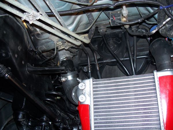

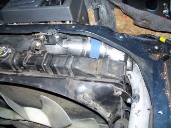

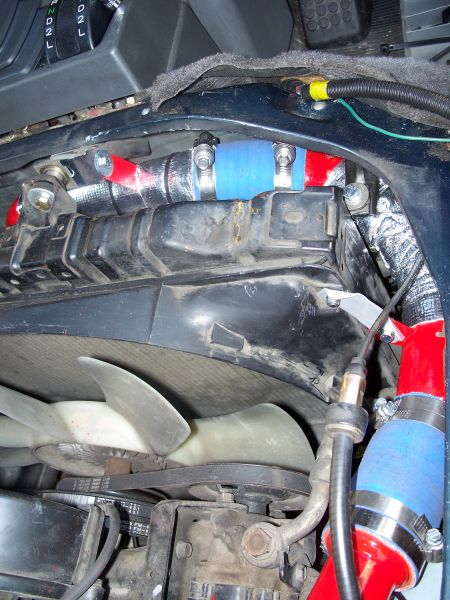

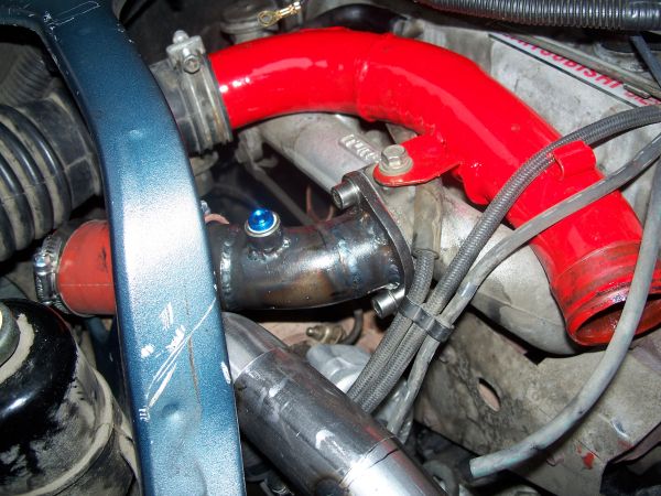

made some headway today.
just to get the piping for the cooler to fit, a lot of pieces had to move.
radiator had to move 3/4 inch to the passenger side.
electric can in front of condensor moved 1 1/2 the other way.
lots of litle stuff like hoses and clamps in the way.
top right condensor mount moved up, bottom one also moved up slightly.
most of the tubing is leftovers from work that I pulled out of the dumpster.
All mild steel because it`s easy to work with. All tig welded seams.
Took some new pic`s tonight, then put it back together so I can go to work tommorow.
- from turbo to intercooler.jpg (49.56 KiB) Viewed 9461 times
- tack welded to check fit.jpg (92.68 KiB) Viewed 9462 times
- inlet done.jpg (89.05 KiB) Viewed 9456 times

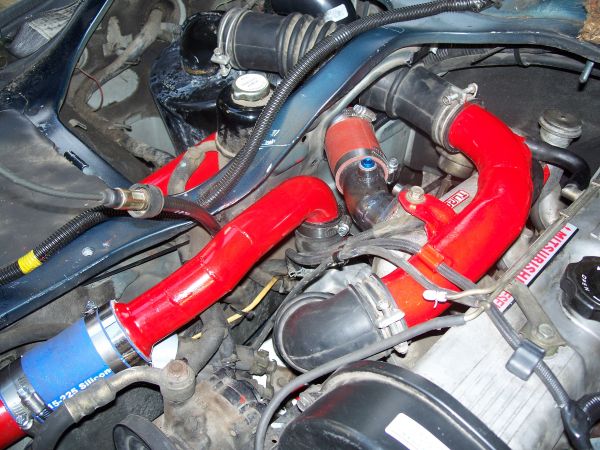

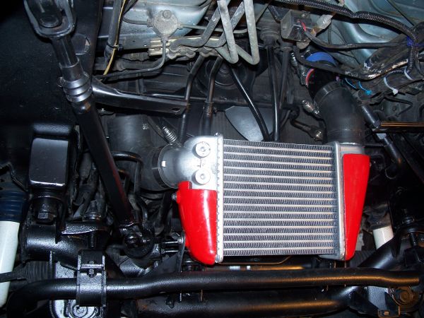

Re: some new upgrades
It`s done.
It`s faster.
It`s faster.

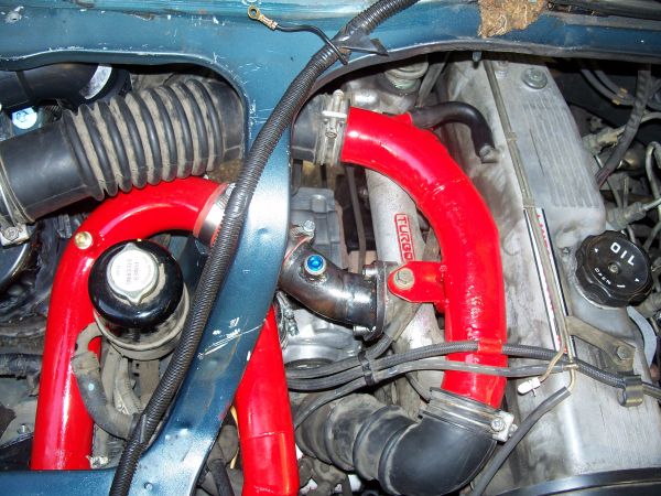

- phpnFdrX7PM.jpg (76.66 KiB) Viewed 9277 times
- phpBU5ADnPM.jpg (89.03 KiB) Viewed 9281 times
- php68HEnPPM.jpg (97.71 KiB) Viewed 9275 times
- php6iLSFHPM.jpg (98.41 KiB) Viewed 9272 times

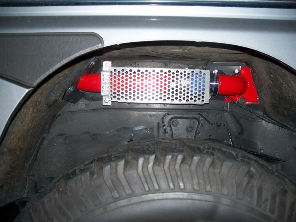

Went for a proper drive today after another day of finshing off a few loose ends.
today just made shure everything was not rubbing on anything else.If I were to do it again, I`d use smaller tubing everywhere.
I`m super happy on the performance now. Seems maybe slightly stronger from a dead stop, but once the boost hits 12 psi, it`s noticably stronger. Going up the cut in n.van, I gained 7 kmh in speed over the top.I didnt get a run at as per usual, stalled behind a slow truck. The best part is that now I can give full fuel all the way up the hill. pyro never went over 900. I never was brave enough to hold full fuel up this hill before. always had to back off 1/2 way up, and just feather the throttle, trying not to go over 1000 deg.
on a side note, I found that my egr valve was stuck slightly open. this was probably not good. Now with it completly gone, and more air going into the engine, the exhaust smoke seems to be less. When I tromp on it, a puff,then tapers off to barely noticable ( for an engine w/ the fuel screw turned up a bit)

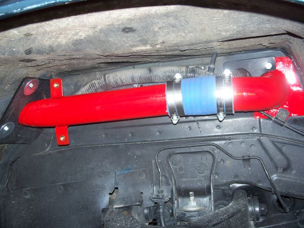

hey jaz,
no lag, which is suprising

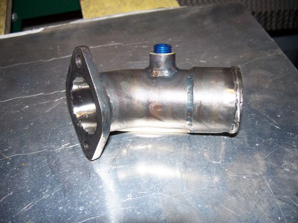

I`d do a lot of routing slightly different, if the a/c was gone.
smaller pipes , both on the drivers side might make it easier. the part around the turbo was where it got tricky.had to roll the turbo,move the aircleaner, cut and reweld the intake pipe on top of manifold, make a block off plate for the egr port on the exh. manifold
total investment still under 200.$
well over 40 hrs of my time, but lots of fun now that it works.
- this is what replaces egr. plug for water-meth.jpg (72.46 KiB) Viewed 9104 times
- cr500 rad guard now arock guard for pipe.jpg (68.35 KiB) Viewed 9104 times
- good pipe fitting critical for nice tig welds.jpg (89.18 KiB) Viewed 9104 times
Garyo - could you draw some lines on your pictures to indicate which is going where (filtered air, turbo air, intercooler air, exhaust)? Just to clear things up?
