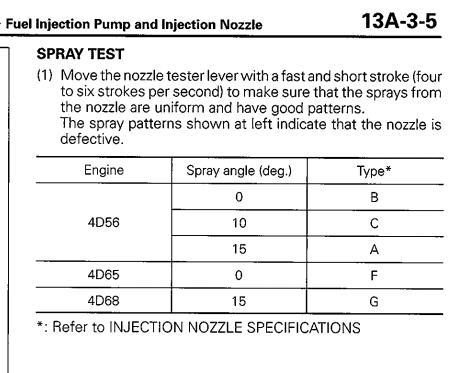

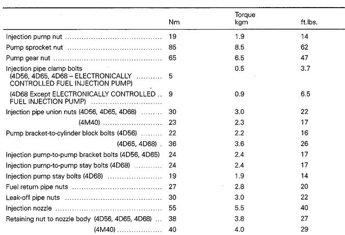

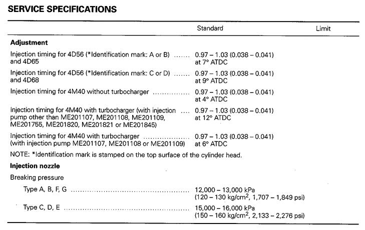

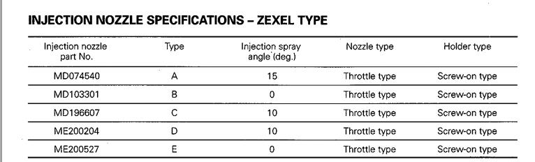

Re: Injector Exchange
Unless someone can show that these injectors are identical and have ran them with no issues in terms of longevity then this whole thread will go around in circles and should be capped.
Below is taken from the service manual.
Part number, torque specs are different.
Even the chinese nozzles I tried out came with 2 different part numbers. One for 4D56T 1995+ and one for 4M40 1996+
As for mentioning Mardy and CVI, there is probably a good reason why they only use the 4M40 injector that is specified by Mitsubishi and not Hyundai as they do not make the 4M40 engine.
