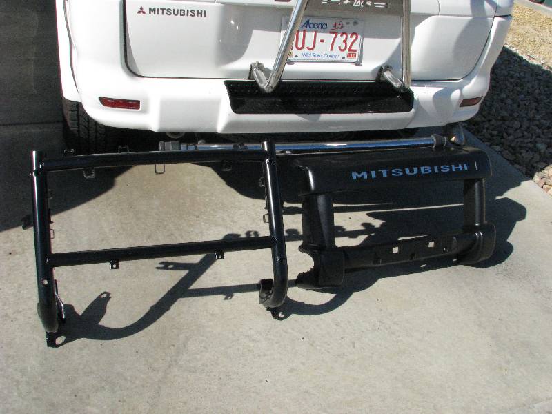

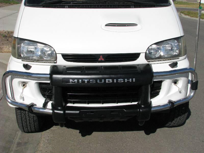

Alright it's showtime! Job is 95% complete as I am waiting for my new bulbs for the fog lights.
It took about three days to paint the middle section of the bull bar with roll bar and chasis paint but boy it was worth it. I sprayed the middle section quite generously in hopes that it won't start to rust again for another 17 years. The shroud took three coats (2 really light and one generous coat) with Krylon Fusion Satin Black. No runs!! I impressed myself. Here is a view of what they looked like before re-assembly:

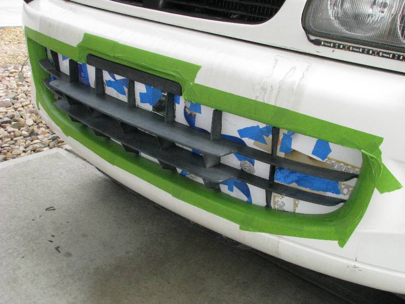

After removing the bull bar I decided that you can't just paint the shroud without painting the fins in the lower grill too. Not being one to do things the easy way, I slid hundreds of tiny pieces of paper into the grill between the metal mesh and the fins and taped around it. It took about an hour and a half and upon completion I realized that removing the whole bumper would have probably taken way less time. Oh well, next time. I also masked and painted the rear step as well - turned out quite nice.

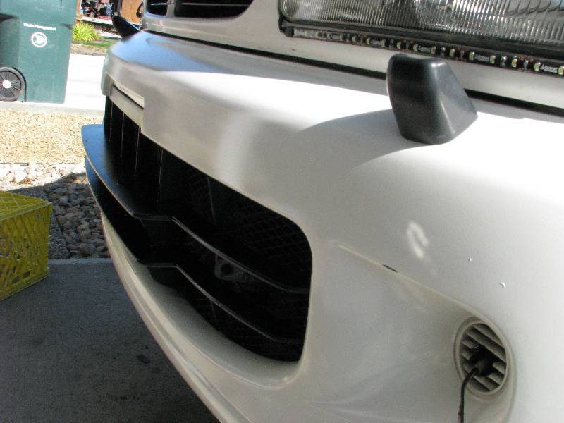

With that done I painted two really light coats and a third coat that was fairly generous again and then removed all the tape very shortly after as I learned from Rick on American Restoration that you want to do it sooner rather than later to avoid dropping flakes of paint off the tape. Once it had a day to dry, I got out the Meguires Deep Crystal Paint Cleaner and did the whole front bumper. It helped alot, but the real helper was Meguires Cleaner Wax. When I finished my wife came out and said "Did you repaint the bumper?" Always nice to have a confidence booster in the house.

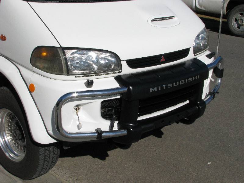

Then with alot of glee and the help of a friend we reassembled the whole thing and put it back on with only minimal scratching of a fin on the bumper. Couldn't have put it on without him because I had to be extra carefull. I had noticed some notches in the one fin as I took everything off - and I found out why when putting it back in! Overall I am very happy with the job. Looks awesome and almost like a new rig again. Really easy to do and would have taken me less time if I wasn't working during my little ones nap times. So now I need my PIAA H3 bulbs to put back intot the lamps and I will remount them and put in another picture. Hope this inspires some of you to do the job too as like I said it was easy and really takes the age off our vans.

Very nice! I'm going to have to do the same to mine some day.
Anyone have a line on more letters? I'm missing 2 - an S and an I I think.

Wow. Great job Cregan. This is now on my to-do list for next spring.

Go to the British Delica Forum and look up my thread there in the Technical section. There is a guy there offering to make them - and you could probably get them in different colours. I didn't bother trying to save my old letters as they looked like garbage. I might have a few left if you want I can see what I got. The pressure washer just blew them off so they were scattered all over my lawn. The new ones are very pretty and I view them as sort of temporary due to the amount of crap that is going to be blasting them so I can always get some more down the road.

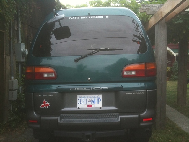

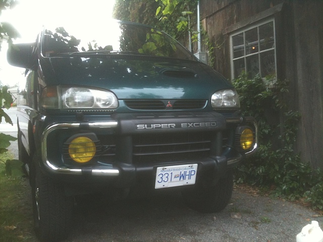

I went to a local sign shop and got em to make up some vinyl letters for me $27
I searched this site for mitsubishi font and found a link for a font called "bitsumishi"
printed the lettering off and gave the sign shop the link and the final sizes I wanted
I put the super exceed on the front and delica on the back and mitsubishi on the back window
For sprucing up the plastic I used a heat gun to get it black then copious amounts of autoglym to keep it that way

Damn that looks great! Impressive.
Sooooo am I the only one who didn't get the sweet LED strip daytime running light from Mardy...mine is a stupid looking globe. I saw Fishtank's in person and the strip looks 100x better. So jealous... :-D

I think you might be - I did however see that they sell the strips at walmart in their cheesy car customization aisle. They are not that expensive - like $10 I think. Go get yourself a set and just swap them over. The wiring is there now.
I agree that they do look sweet. Give the curb appeal and view of like an Audi or Beamer. Classy!
