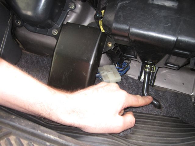

Here's a shot of the easiest wet floor fix - If this hose gets kicked loose you'll have a wet floor. The windshield can be a problem as well - water gets in and can find it's way around into the floor.
Good luck!
Good luck!
