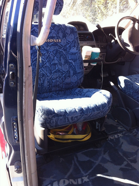

Did it , Used all 4 original bolt locations though. Took a bit more welding but I'm happy with it. The new seat sits exactly where the old one was, I removed the left side arm rest because it was too easy to get the shoulder strap tangled up in it.

Rik, did you weld it in the same 2 rear-most places that I did (see pics)?
The two front holes lined up perfectly. Left-most (door side) hole was exposed so just welded an L-bracket drilled out. The inner (driver side) one was more challenging and made a 2-part bracket as the bolt hole rests just below the track itself.

I used the hole thats hidden by the track by drilling thru the track and welding some reinforcement on the bottom of the track, the hardest part was creating clearance for a socket to tighten the bolt while not screwing up the locking/sliding bits.
I also had to do a bit of carving on the insulation under the carpet to get some clearance when you swivel.
I plan on getting a replacement rear seat for the odd time I'm hauling a crowd and I think I will cut the tracks short on that and just use the rear 4 bolts. So the rear seat will swivel but not slide. I will only have that seat installed when I need it.
I think I will tackle the drivers seat this spring or summer.
I had to do some minor shimming to get it all moving smoothly but I'm confident it's a secure as stock.

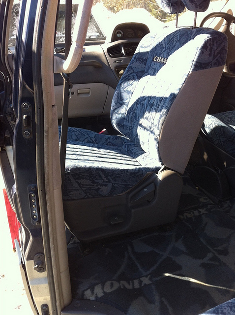

With that said I've fitted a T4 swivel base (2 holes shifted over) to the passenger side. It sits 2" inches higher than the driver's seat though.
