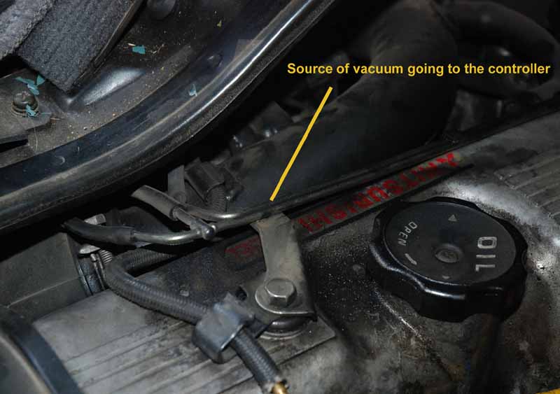

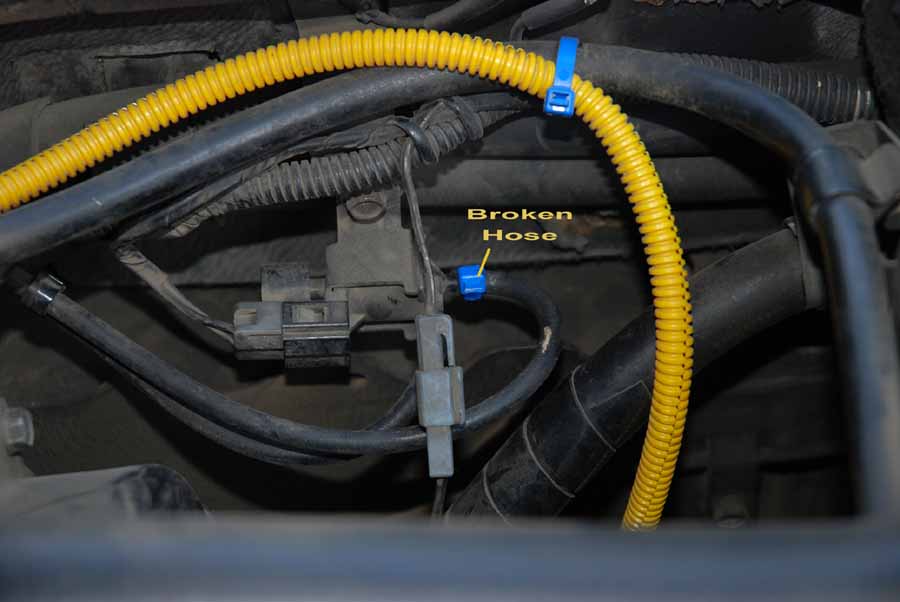

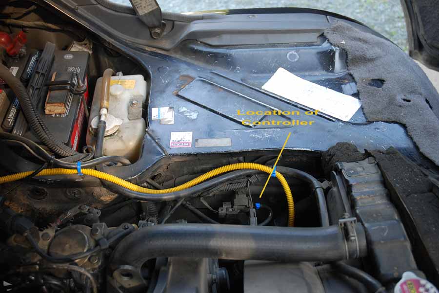

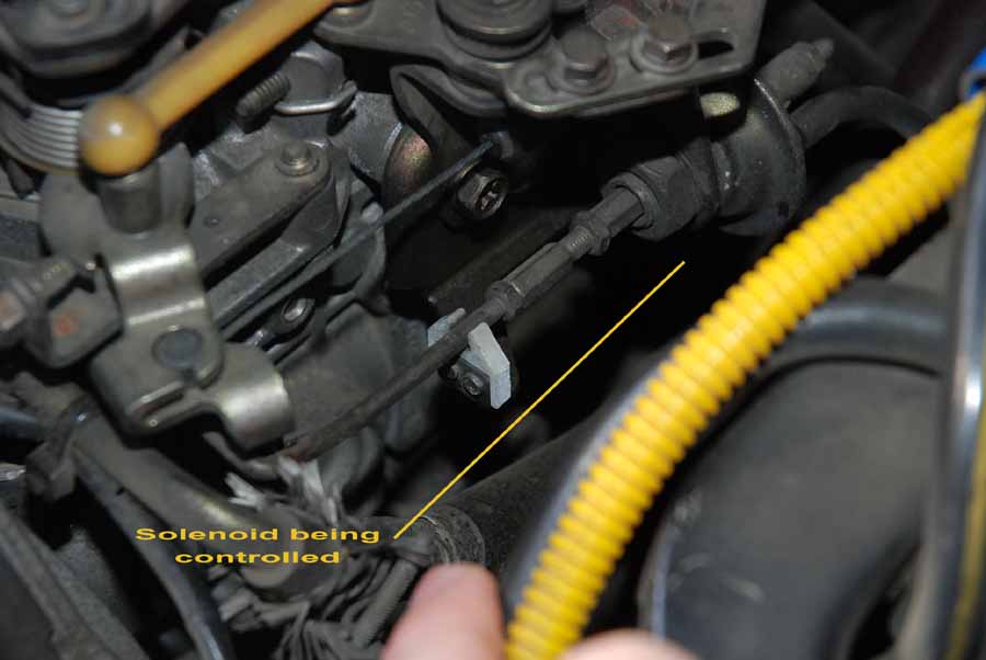

So I had a quick look under the hood today to try and solve this issue. I did a few things and it seems to have helped...of coarse I did them all at once so maybe one or maybe all helped. The first thing I did was to lube the throttle cable. The second thing I did was adjust the idle to decrease the idle. Then I was looking around and saw what I believe is a vacuum line that had cracked and come off some type of solenoid controller. It looks like the controller might be for cold starts as the solenoid itself looks like it would pull on the throttle. Either way I fixed the hose. This would have been a big source of a vacuum leak (assuming it was a vacuum hose). Have a look at the pictures and see if you think I am right on what it is. For the record the yellow hose protects the air line going to my boost gauge.

Mark,
The solenoid you are looking at in the pictures is to maintain the idle of the engine when the A/C is switched on. Just lubricating the cables probably helped your situation, but I doubt the solenoid has anything to do with the bigger problem.

So is this the high idle that Eric was suggesting as my potential problem?
EricN wrote:Pop the vacuum hose off of the actuator for the high idle and drive like that. If the problem persists, it is something else.
I guess if it is I was doing what he had suggested by the fact it was disconnected already. I can say after a second test drive tonight that the increasing idle issue seems to be gone. I agree the only thing that makes sense for this fix was the lubrication of the cable....simple got like that!
