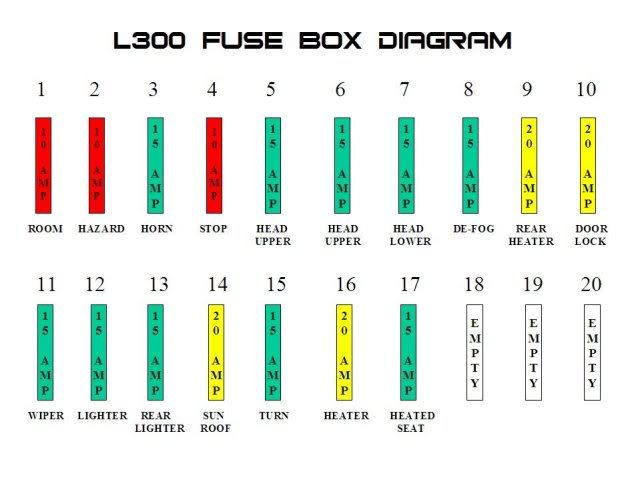

Hazard lights get their power from fuse #2 (10A) not the turn signal fuse #15 (15A) so they would continue to work even if the indicators/dash warning lights/reverse lamps/PRNDL/overdrive switch failed.
(In my earlier post I said "dashboard lights" but meant "dashboard warning lights" (as opposed to "dashboard illumination"), sorry.)

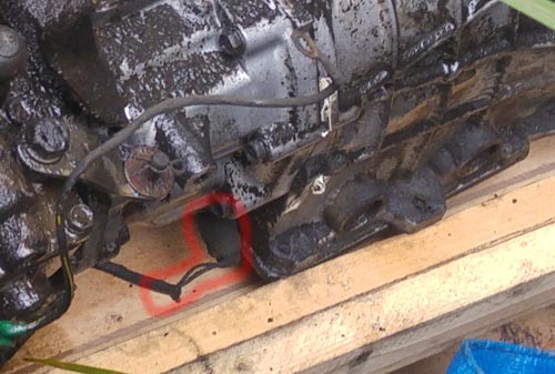

Reverse switch is on the right side of the gearbox, just behind the oil pan. Here's a photo of my gearbox just after I removed it, taken from above, with the reverse switch circled:
(I'd take a better photo now the gearbox is installed, but it's dark outside now).
The switch has long wires coming out of it, the wires run over the gearbox and plug into the main loom at a couple of bullet terminals on the left side of the gearbox. Try not to disturb the wires where they actually go into the switch, the insulation is usually brittle and will crack.
