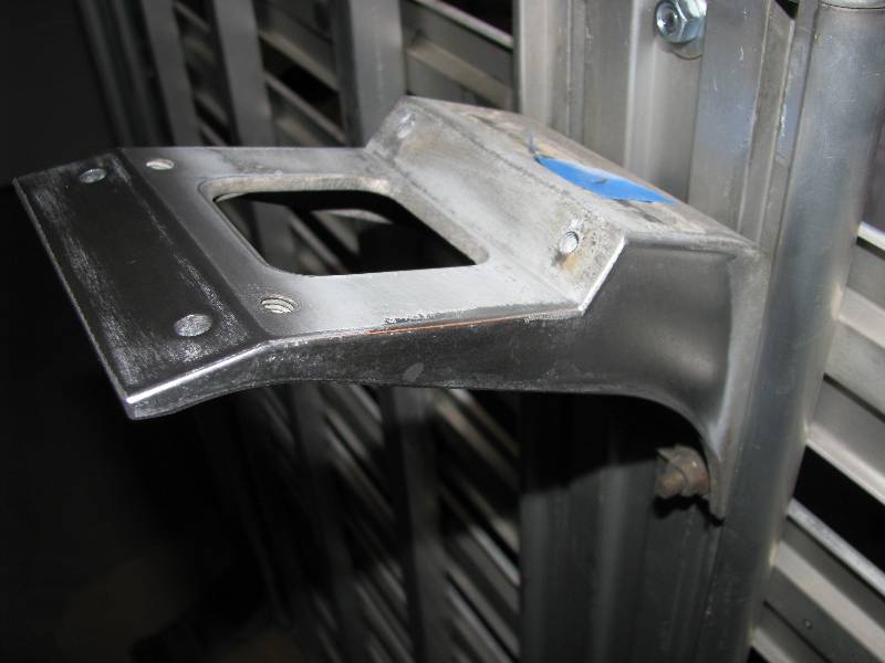

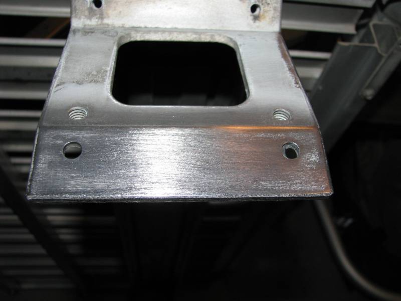

Tried all 3 different types of polish today (Mothers, Autosol, and Magic Mix) with no success. I know that when you use these polished you should see the rag and polish on it turn black. Nothing would happen. THEN I decided I would rough it up a bit using first the brass brush which worked to an extent at getting the bigger chunks of whatever was on there off. Then I used some 220 grit sandpaper. Things started happening. The polish immediately turned really black and I got a shine starting. Here are some pics:

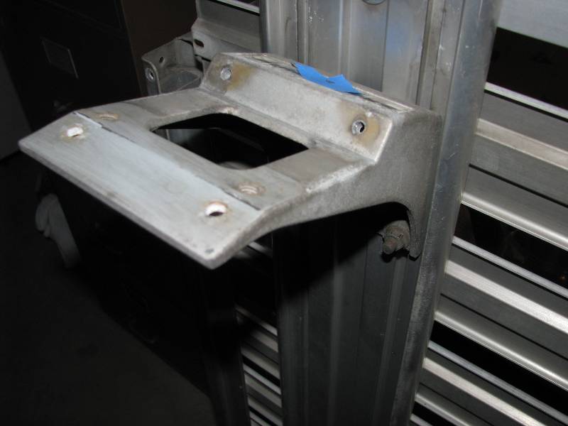

Here is what I was dealing with before:
So it would seem that I need to rough it up a bit in order to get the desired amount of blingyness. The two methods I have used are leaving scratches so what would be a better alternative to these that will take off the coating of crap but not leave scratches? I have been interwebbing and found that i should do it in stages of rough to fine sanding. I have a hand grinder, orbital polisher, and two arms (complete with hands!) at my disposal. I would like to use the grinder if at all possible as I like this rack, but I don't LOVE this rack so wasting copius amounts of time would probably help me to be one step closer to being a bachelor again. What do you think?

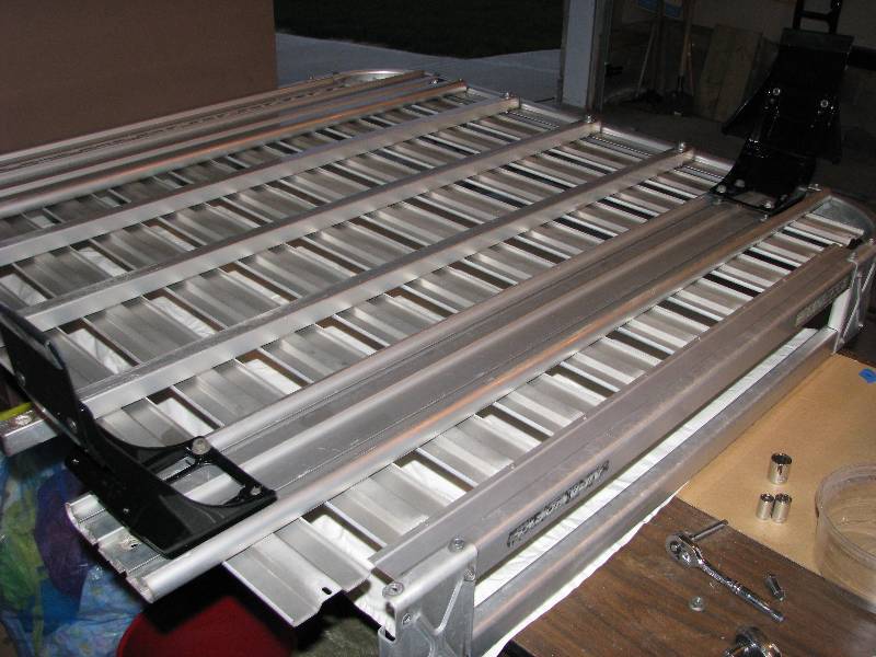

Yeah I like the black- It is a safe bet I think (in regards to the roof rack legs- with the ladies there is no safe bet 8-) ) Red would really pop, but I really don't want a set of the red JAOS flappers. I did some more reading on the ol' Interweb and got the translate to work on the AIBA site. Turns out my rack is the lightwieght aluminum ANNODIZED model know as the Noselda 2. This explains alot. I think I will leave the basket alone and just spit shine it.
I have a few more mods to surprise you with coming up. I think I will make my own thread (1 to 2 pages - kind of the opposite of Nick :-) ) when it is done to show the transformation.

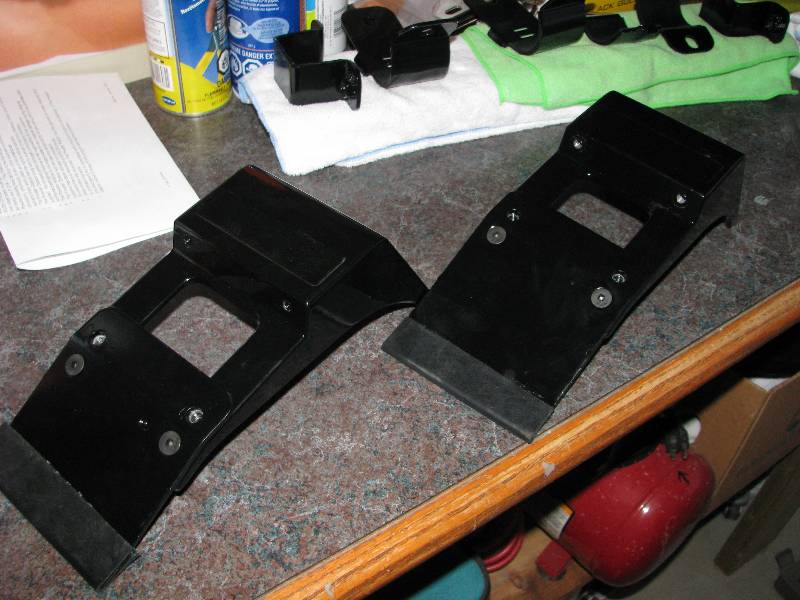

Got the feet back from the powder coaters and reassembled. I like it alot. Pictures of it on the van to follow this weekend.
Craig
