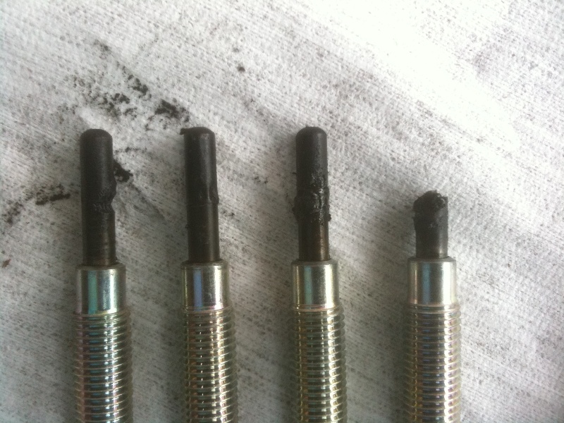

Re: Glow plugs.....glow plugs.....
Hi CJ
My mistake. 6V plugs in a post-1992* (1993 or newer) with the watercooled head-turbo using the 11V glow plug system is the bad combo.
This is what can happen if the incorrect glow plug is used leading to piston/head damage. In this case, it was an owner who used the correct glow plug as per the manual recommendation in the delica wiki, but because they have a 1992, they assumed that they use 6V glow plugs. Unfortunate for them, it was the wrong glow plug for the engine/production month.
*Some Nov/December production 1992 L300 models come with the 11V system/water cooled turbo.
- IMG_1328.jpg (200.56 KiB) Viewed 4261 times

that picture makes me cringe hahahaha
"There's a uh, big machine in the sky, some kind of, I dunno, electric snake, coming straight at us!"
You wouldn't want to see the #1 piston. top looks like a black golf ball.
