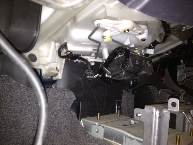

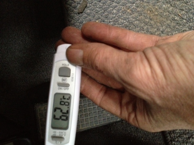

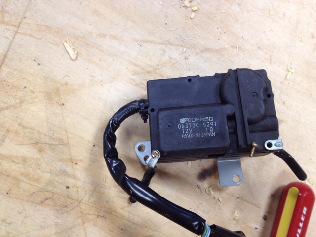

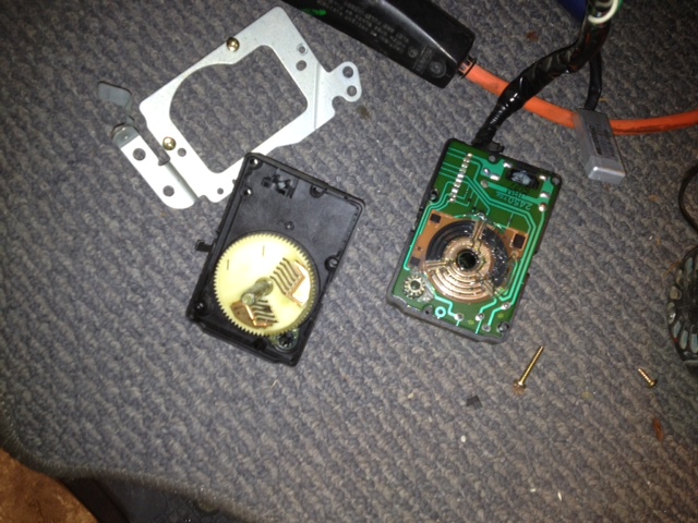

I Got Heat!!!!!
The motor that is controlled by the TEMP up and down switch wasn't working, to access it a bunch of lower dash panels and duct work has to come out and then you need very small hands and stubby screwdrivers .
I found the motor was getting power so I took it out and gave it a stern talking to.
Then I took the cover off and there is a multitude of delicate copper arms that rub on contacts on a circuit board.
A little more finger waving mixed with colourful language and I reassembled the casing and hooked it up to 12v power supply and lo and behold it started dancing like a little robot.
So reassembly back into the van with a not unreasonable number of screws left over and I have 60c at the vents where I had 18c 5 hrs ago.
If it crapps out again I'll toss the motor and replace it with a manual cable control.

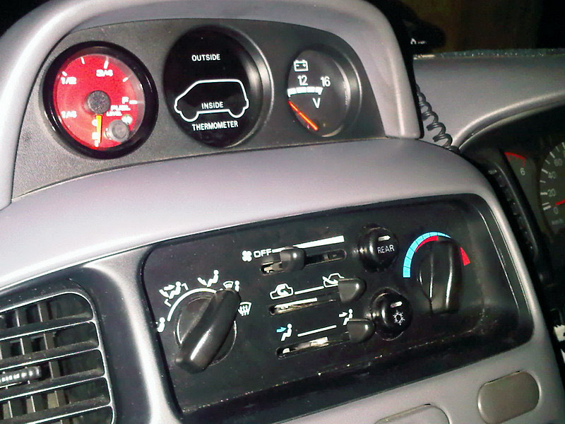

- Profister
- Posts: 963
Re: absolutley no heat...
This is one of the reasons why I drive a Chamonix. Keep it simple!

Reviving an oldie but a goodie since I might tackle this on the weekend. What did you do once you opened the black box to get it all moving again? Clean the contacts? Just gently move the arms back and forth? Voodoo ritual?
Artacoma wrote:I Got Heat!!!!!
- Artacoma
- Posts: 569
- Vehicle: 97 V6 LWB
- Location: Victoria BC
Ha! Be brave
Open the box on a clean flat work surface.
I cleaned the contacts and veeeeerrryyy carefully gave the little copper arms a titch more bend so they put a bit more pressure on the circuit board then redistributed the grease.
The hardest part was getting some slack in the wire harness to get it out.
I was worried the rotation of the plastic gear would be off when I reassembled but it seemed to reset itself once I hooked up power.
The reassembly was waaaaay easy , I guess that explains the extra screws.
This is a finicky fix and you have to be able to remain calm for an extended period ..... be brave ...... it's worth it.
