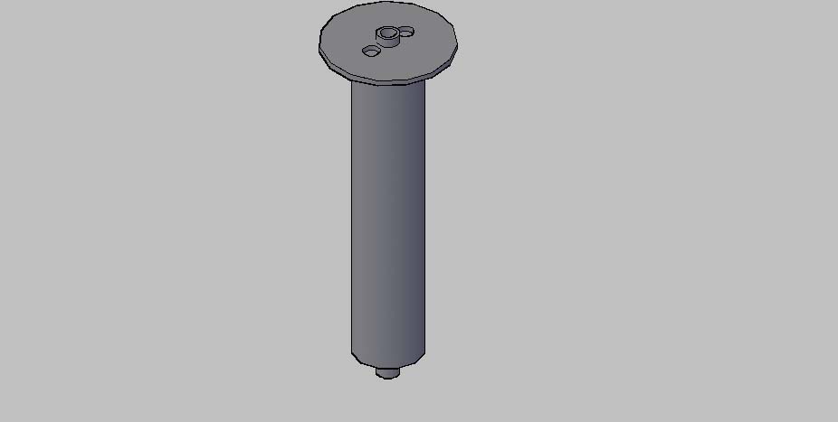

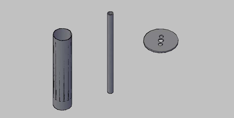

Re: Vegtherm Questions
I'll make you a 3d cad drawing tonight of the basic design and post it as a jpg. It is just a tube with a bigger tube over top. After driving it today I am convinced it is the fuel that is the main cause of cooling everything down. Around town, I can get temps to 170 but get on the highway with sustained hi rpms, fuel temp drops a degree every 5-10 seconds and rests around 134 or so. Vegtherm will heat it up from there but it is slow. I went and bought the same pump (only about $60 and came with a filter) as Adam too (thanks for the research man) and I am going to build the surge tank today. There is a nice little spot for it to sit underneath between the rear heater box and the wheel arch.
Ok, this is rough but it was quick.
The three parts, skinny tube is the one that the fuel goes through, thread the hole to 1/4" NPT, (hotfox uses a large 1/2" pipe) on the top so you can attach a fitting. The fat tube is the one that the coolant flows through. The bottom of the fat tube needs a plate welded to it, then a hole drilled in the center to allow the skinny tube to pass through, then weld that together. The big circle is the mounting flange. The same hole that is in the bottom needs to be in the top for the same reason, the fuel tube passes through. Weld it on. Then you need 2 holes on either side of the fuel tube that are threaded to 1/4" NPT also so you can stick in your fittings. Just make sure that the holes feed into the void of the large tube that will be filled with coolant. Then drill the mounting holes along the outside of the flange. There you go that is it. Sorry if I dont make any sense, not feeling well, that is the best I can explain it at this time. Feel free to ask me to clarify. I am going to buy the parts tomorrow so I can make one, just because.

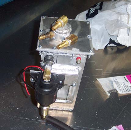

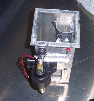

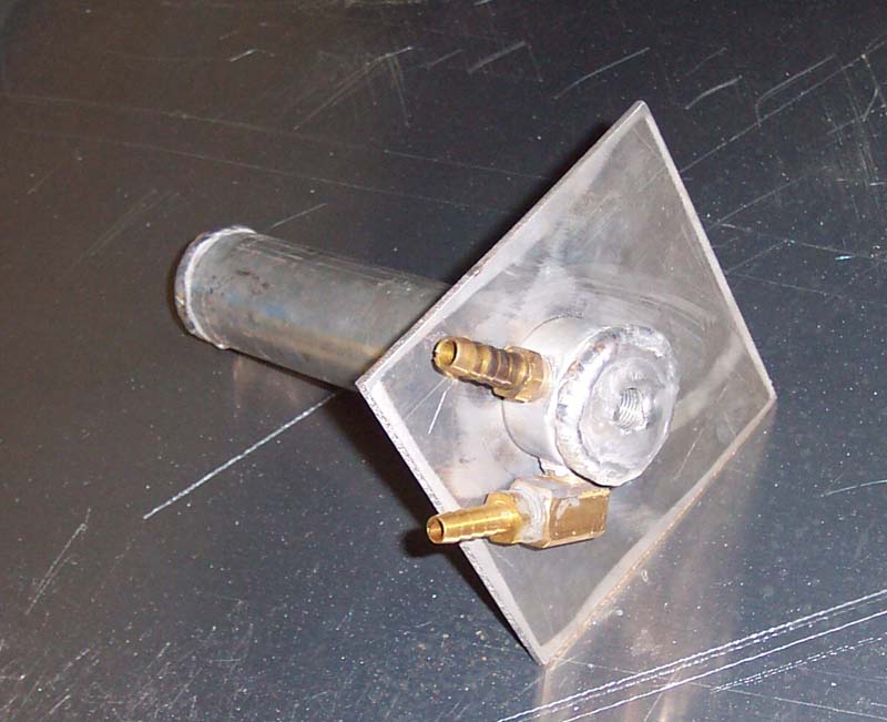

Ok, built one, had a bit of a design change though. There is not enough room to fit all 3 fittings across the top so I raised it all and put the coolant holes through the side. If I had planned for this I would have bought longer tubes so that the top plate wouldnt interfere with the 90 degree fitting. Instead I just threaded the fitting on first then welded the plate. The little plastic thing in there is an old brake fluid cap with a level sensor float. I am using it to trigger the low fuel warning for my VO controller to shut off the veggie.
All assembled like that it fits perfectly between the wheel well and the rear heater box.
